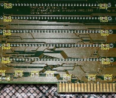

I've taken and attached a picture of the board, I booted the Amiga just now and again on cold boot I get the defect screen and after a soft reboot it seems to work thereafter so maybe I have set the jumpers wrong somewhere.
When I tried this board with my main A4000 it wouldn't even boot, just the defect screen that had a standard daughter board but it has buster 9.
The A4000 Elbox tower I've installed it in now has buster 11 on the motherboard and its a 7 slot elbox zorro board not a mediator in this setup, I've attached a couple of ectra pics of the setup.
The person who owned this board before me said that he has run this board with 256mb, however for now thats not an issue as I only have the 48mb of 4mb Simms so at this stage at least I'm not too worried about exploring that further, as long as it works in the configuration for now I'll be happy :cool:

Also m8, have you found the Silk Screened Version number of the PCB yet? It's on the back side as per pic below. Very hard to see on some boards unless you just get the angle right. ;)
Kin
I didn't yet no, but next time its out I'll take a look at the board.
