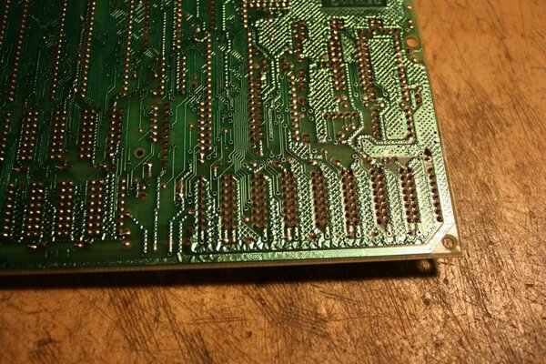

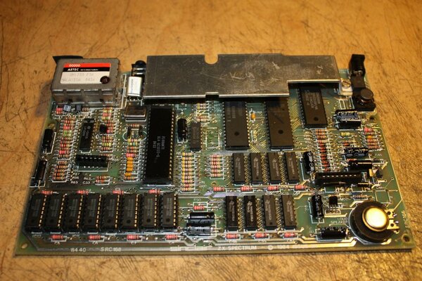

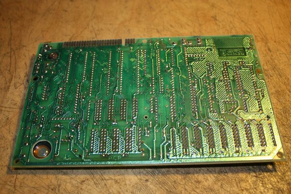

And here's some pictures of the repair and working screenshot.
Sadly the only fully functioning ULA I have spare is for ISS 2/3 Boards
This board requires a 6C001E-7
I will return it with a semi functioning 6C001E-6 is use for testing to show it's working, this ULA's keyboard input lines are naffed.
Composite Video mod also added.
TC :)
