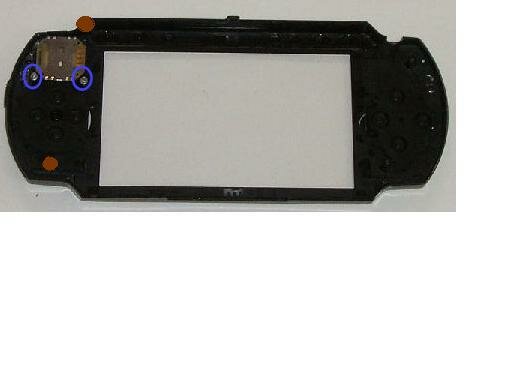

Just a quick update to mention how I fixed the problem with the analogue stick. It was as mentioned moving (character or menu etc) when it was being used in games when it was meant to be still, I found that there was actually nothing wrong with the stick itself. When the stick is separated from the main board the movement still continued which meant that there was probably a contact problem so I tried it out by removing the stick from the front cover and firmly holding it in place while a game was running and it worked as it was meant to.
The way I sorted out the problem was by filing off a small amount from the 2 screw pillars that screw the case together where the analogue stick is situated, this allows a little extra pressure to be applied to the analogue stick and its connection to the main board and that is about it. I had looked at other methods on the internet but they didn't work so that is when I tried something different
The brown dots are where the 2 pillars are that I filed down a bit, the picture is originally from here and I just added the two dots for convenience.
Maybe this will come in useful for others as a last resort, I can say however that I a pleased with the results and there is no damage to the casing to be seen
