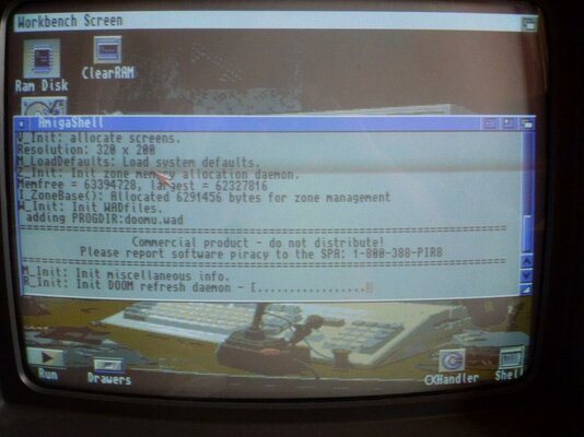

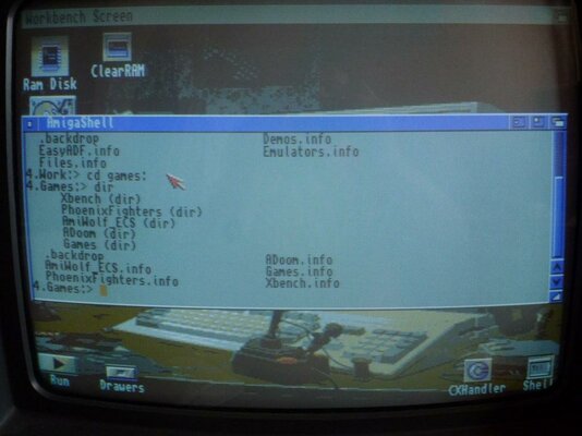

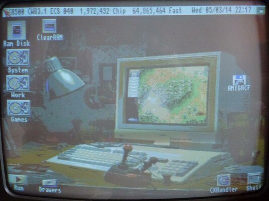

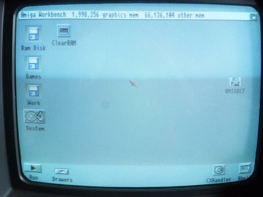

So I had a go at this today :whistle:
Using Toni's 060 libs and latest FW, it loads up but with Classic Workbench Full if I click on any Icons it guru's, can use the shell fine though but if I load any programs it crashes too.
If I boot without Scalos then I can use Workbench fine but it still crashes when I try to launch programs. I guess I need to use a more basic Workbench setup and try again.
Cool to see a Blizzard 1260 running on an A500 though :ninja:

Standard quick reply: you have too old setpatch or you need dummy 68040.library. Your system is not using 68060.library (No FPU = not in use) and also runs slowly.
I copied both 040 and 060 library from your archive so I guess I need to update setpatch then?
Check by running setpatch manually: It should say "68060 support code loaded".
C:CPU should say "CPU 680x0 FPU: 68882". It may say 68040 CPU if command is too old, it does not really matter, but if it does not include "FPU: 68882", 68060.library is not loaded or not working.
SetPatch is available from Aminet.
