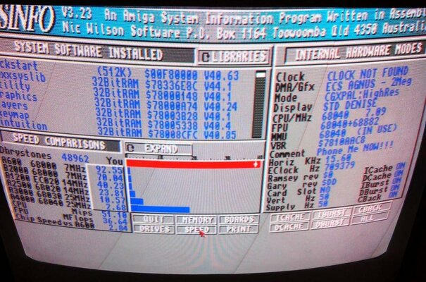

A question to the 1260/1240 users - how does your 1260/1240 perform? My 1260 shows another behavior than the 1240. In short - the A500 work with the 1240 flawless - no systemcrashes. With the 1260 I have some weird crashes.
Prefs/Sreenmode - crash, Icon/Information from the bootpartition - crash, Tools/HD Toolbox - crash, Sysinfo - crash, fxpaint - crash. No crashes with the 1240.
From scratch installed games and programms are working well. (except FxPaint) WHDLoad Games are working. (for some I have to set "NoAutovec" in the Tooltypes) So overall the 1260 is working - but shows some strange behavior compared to the 1240. Am I online with these problems?

Does C:CPU say you have 68060 with 68882 FPU or only a 68060?
If no FPU: you don't have 68060.library in use, older setpatch versions don't load it without having dummy 68040.library. Download normal 68060.library package, unpack dummy 68040.library in LIBS: (It is the one that is few hundred bytes in size). Or download latest setpatch from aminet.
Thank you Toni - that was the hint!! :) Now everything is working, except some WHDGames - they have heavy slowdowns (e.g Turrican II & III) The music is slow and the game is unplayable, but most of the games are working very well.

I found a solution, it is quite ugly hack but it does work, 68060.library works, FPU works. Sysinfo won't crash anymore and results are slightly faster than previously.
Replace your libs:68060.library with this one: http://www.winuae.net/files/b/ACA500_Blizzard1260_Hack.zip
(DO NOT USE if you don't use it with ACA500!)
It is Phase5 68060.library patched to not clear ITT0 and DTT0 registers. (Transparent translation registers that ACA500 uses to mark lower 16M as uncacheable for both data and instruction), these registers have priority over MMU tables.
Note that most likely any debugging program (like enforcer) won't anymore work with chip ram (or any ram inside first 16M), also this hack won't work if any program touches ITT0 or DTT0.

It is hardware problem, not software. A1200 Blizzard boards don't support 16-bit memory when 040/060 attempts to fill cache line(s) using 32-bit burst fetches.
System crashes long before Amiga boots or setpatch loads. ACA500 does not (anymore) crash because flash code runs first and it will now patch maprommed KS ROM to set compatible TTR register contents before caches are enabled. (Normally instruction caching is always enabled for all addresses, ACA500 disables all caching from low 16M if 68040/060 CPU)
680x0.library would enable low memory caching again (instruction caching everywhere, data caches in any non-chip ram) which would crash the system again. Patched 680x0.library again forces full low 16M as uncacheable to fix the crash. System is still fast because Blizzard's own RAM is outside of first 16M.
