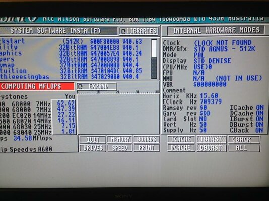

It runs fine as long as you don't run any programs that touch MMU or TTRs (transparent translation registers) or it will immediately hang the system because they restore original and incompatible cache settings for lowest 16M of address space. Also FPU is disabled and can't be used.
68040/060 library update or patch is needed that keeps lowest 16M totally uncacheable (for both data and instruction caches).
btw, "C:CPU cache" can be used to enable data caches (noticeable speed increase) but it will break SCSI expansion because it is DMA and DMA controllers require proper MMU tables with 68040 or 68060 CPUs.

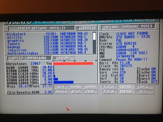

sysinfo on the 060 with the ACA
a quick pic before it reboots..

I found a solution, it is quite ugly hack but it does work, 68060.library works, FPU works. Sysinfo won't crash anymore and results are slightly faster than previously.
Replace your libs:68060.library with this one: http://www.winuae.net/files/b/ACA500_Blizzard1260_Hack.zip
(DO NOT USE if you don't use it with ACA500!)
It is Phase5 68060.library patched to not clear ITT0 and DTT0 registers. (Transparent translation registers that ACA500 uses to mark lower 16M as uncacheable for both data and instruction), these registers have priority over MMU tables.
Note that most likely any debugging program (like enforcer) won't anymore work with chip ram (or any ram inside first 16M), also this hack won't work if any program touches ITT0 or DTT0.

Sysinfo working
which amiga still crashes tho
info shows cpu68040

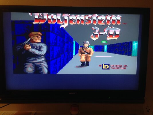

I really didn't except it to work but it did. Even whdload seems to work.

It surely disables MMU and TTRs completely while doing system checks.
info shows cpu68040
Too old program that knows nothing about 68060?
i was thinking 3.1 and sysinfo dont know anything about the 060.
it just shows as a 040.

all working , even doom zips along at a fair old lick...and in OCS with 512k chip ram...amazing
