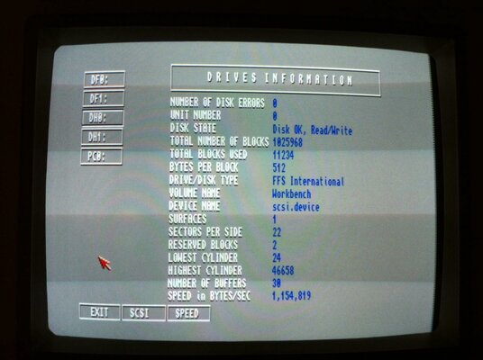

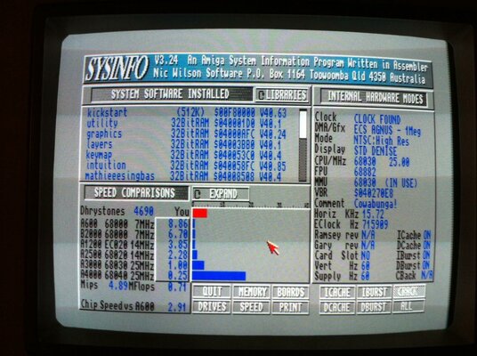

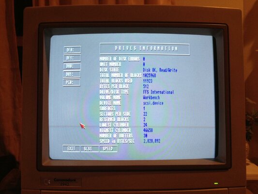

I will get that other tool to measure the speed and see how it does. So how does lowering the priority to 0 help with benchmarking?
The A2091 will DMA to A2630 memory first if it's the same priority as 2632 memory so it lets you compare standard DMA vs. buffered DMA. The other tips (see edit) should help to speed up buffered DMA.
With this patch, can you still run the controller at stock speeds? Or ASync mode?
