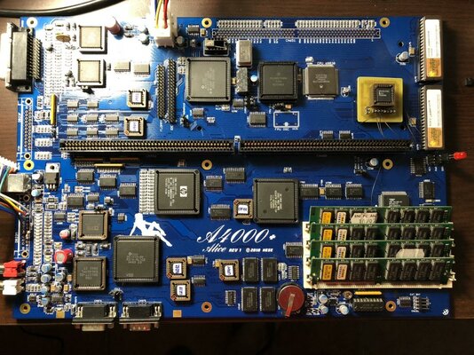

Another board working!!! After some time stopped by a fake '030 (and some rework on CHIP RAM, because I got a green screen) now I have my A4000+ Alice working!
At the moment I only have 16 MB of fast RAM, but I have all ready to make meutoxo 64 MB hack (I know there is 112 MB hack, but It's more intrusive than 64MB hack). I will tell if I get success (we need an additional GAL to make the hack, and we need to wire it...)
Hese, any news about the CPU connectors? When you can supply them, I will go for a Chucky 3660 board!!!
Would you be willing to share a picture of your completed board shanshe
For sure!!!
Curiosities:
Video conector (no DB23) is for connecting a GBS8200.
Meutoxo 64 MB Hack socketed over RAMSEY (my own equations written in vhdl for GAL22V10). Working!!!
Other custom chips socketed.
28.375MHz SMD instead of 28.37516MHz DIL.
Well, I think that soon I'll need a case... thinking on methacrytlate.
Other than that, I have all I need for now, except a mouse from Amikit that is getting more than 2 weeks to send it to me!!!! :Doh:
