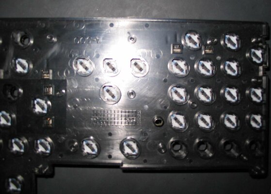

Well, Sardine nailed it. I forgot to hook up the audio cable to the monitor. :( Kind of embarrasing.
Now on to the enter key. I have it apart and want to switch a key to see if the problem follows the key. So, how do you remove any key from the keyboard frame without breaking anything?

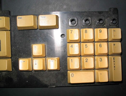

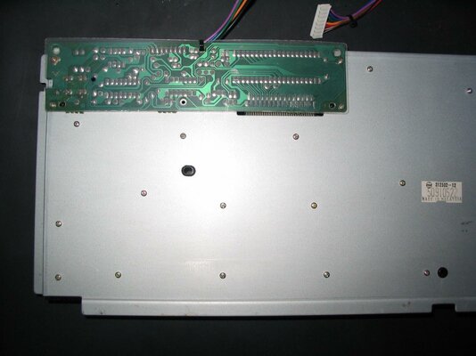

Disconnect the keyboard connector from the motherboard header (take a note of the proper orientation) and remove the keyboard (there are 4 plastic flaps at the bottom of the case it slides under, it's surprisingly easy to break one if you don't slide the keyboard out properly).
(Photo #1) Look at the back side and undo the 27 small screws on the backplate (there are another 4 screws on the PCB rectangle, no need to remove them). It is actually a good idea to arrange the 27 removed screws so that you remember which screwhole each one came from when you re-assemble the keyboard.
(Photos #2 and #3) Once the screws are removed, you can detach the black plastic base. The keys will not fall off. Take a look at its underside, you'll spot each key's fitting post with the conductive bridge at the end.
See here for some ideas and photos on how to unhook keys or posts without causing damage. The key springs tend to jump around, don't lose any. It may be a bit tricky to unhook the Enter key for your first time dealing with a keyboard (there are hinges and metal clips under it) so you might actually prefer to undo the fitting post as shown on the last photo.
Once the plastic base is detached, the membrane will be exposed. Give it a good visual check too. You can actually reconnect the keyboard that way and begin shorting pads while in a CLI windows to test for membrane functionality on any suspect keys.
These apply to the Mitsumi keyboard model, which is by far the most common one.
