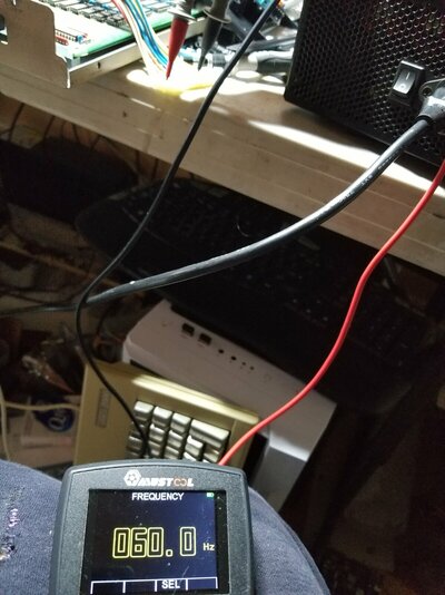

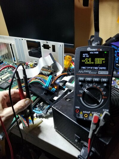

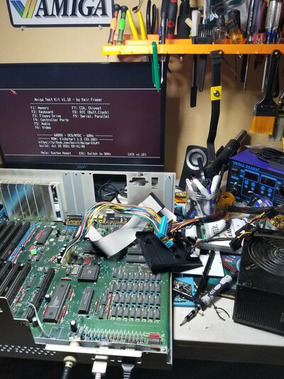

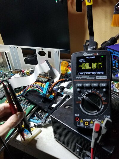

Sorry for the delay on this feedback but I am very busy and I wanted the seller and any potential buyers to get the best review possible.
The "tick" signal is a steady 60Hz and all voltages are within "Gold-Platinum" tolerances @ <1-2%.
These are VERY High Quality and are sure to increase the life of your Amiga by reducing component strain and other issues caused by the poor quality of a power supply from the mid to late 80s. The machine in the picture benefitted from the ATX PSU and adapter immediately as prior to its installation the machine had an intermittent boot issue (no doubt caused by faulty power) that is completely gone.
