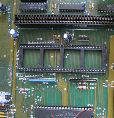

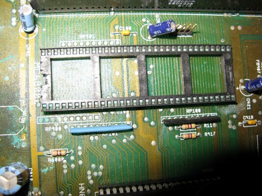

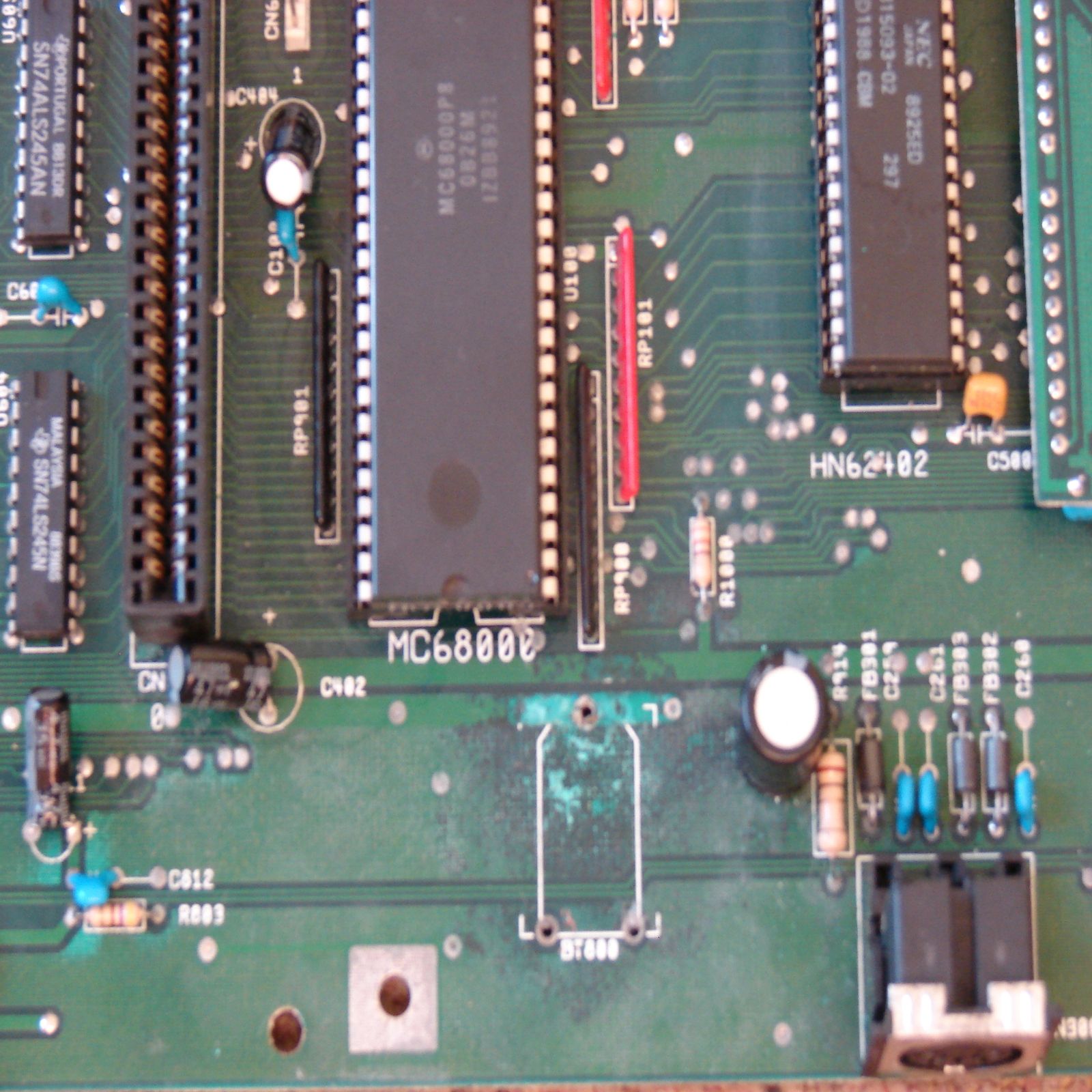

Hi
I need your help guys. I have just received my new Amiga 2000 computer, standard one, revision 6 motherboard, one floppy, 2MB RAM on A2058 and a GVP SCSI card with a hard disk.
When connected I can ear one disk drive click, the power led is always on and the Caps Lock led keyboard isn´t blinking, and a black scrren on my TV, I connect it via an A520 video adapter in perfect working order.
I noticed a bit of battery lacking, so I remove the battery and clean the board with isopropylic alcohol.
I disconnect the hard disk card and the memory expansion and try again, no luck, same black screen.
So I tried every chip on my Amiga 500, 68000, ROM, Paula, Denise, Gary and CIAs, and all chips from my Amiga 2000 works perfectly on my Amiga 500. So What more can I do?
Thanks in advance
