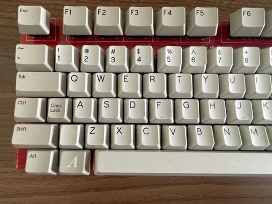

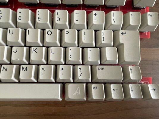

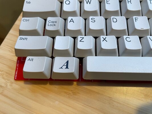

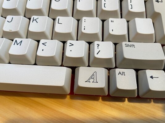

I think many of us should thank you for the A1200 board design since if you had not made it available to the masses we would still be waiting for Amiga on the Lake to get off their dead behinds to make the 1200 keyboards they said would be out for sale 3 or 4 years ago!! Again thank you very much!!!As a result of these keycaps I am revising my A1200 and A600 keyboard designs. If you have one of the current version you won't want to update, nothing much will change - I just feel like doing it again, making the routing a bit neater, using low-profile switches and accommodating different spacebar widths. I'll announce when the repo is public. Well done Steveed for getting the caps made!
