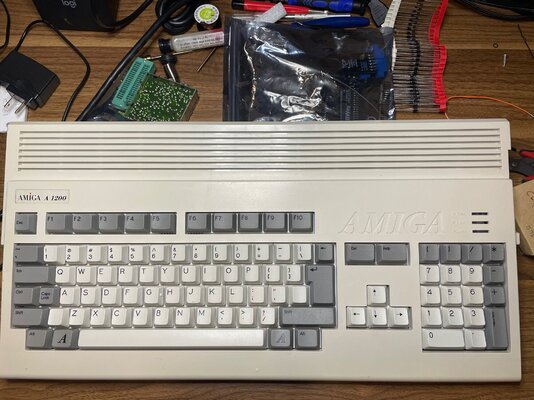

I think I have it now though and am sending out a couple of keyboards to testers. The one on my A1200 is working great, but the LEDs are in the wrong order! That's what happens when you design a PCB before you receive the case!
