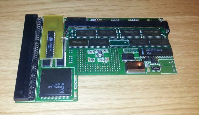

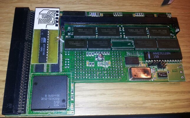

Well here goes what I think:

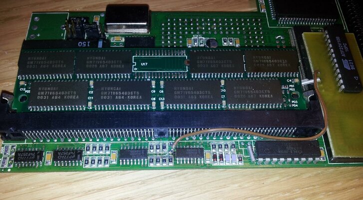

If we use plcc or dip, trap door will not close. Solution: use soic gal.
Advantage: Board is the same size as socket.
There is no need to put socket bellow board if you solder eprom directly. If you use a slim 128mb simm it will fit perfectly.(This 128mb simm is broken)
So with this new design, we can get cheaper boards.
Here are the connections needed:

i just thought i would share something with you,as i don't know if you know this or not.
if you program a 27c010 with the 060 firmware it will work with a 040 onboard.

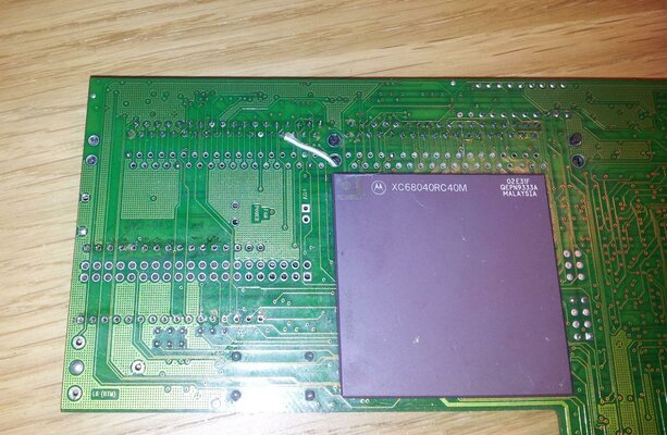

I already have here an apollo 1260 at 80mhz. Courtesy of JCarvalho. It runs perfect with 64mb in one simm. the back simm I have some issues due to limitations of gal chip it only sees 16mb from 32 or 64mb simms.
The other 1240 already has 5.60 with 27c1001 soldered to board and it works :)
Still waiting for 128mb simms!
was the issue already there before mounting the gal?
i had a apollo that had problems after the second slot was added,turns out it was a bad connection.
it would only se half of the simm i put in there(one side)
but its encouraging that the card see's more than 64mb.
