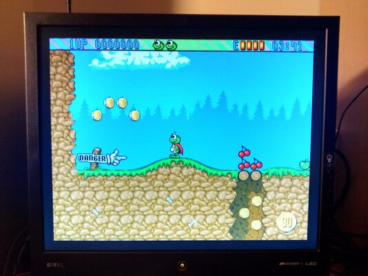

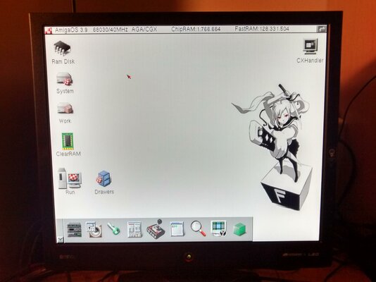

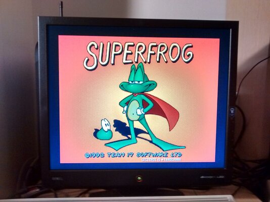

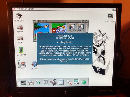

The monitor saves automatically different settings according to the frequency of the selected screen mode (more or less...).
In my case i have the monitor auto-switching settings from Wokbench (Productivity screen mode) and games/demos (low/hi-res PAL).
EDIT:
Here are my Workbench settings:
Amiga side:
  • ScreenMode - Multiscan Productivity 640x480
  • Overscan - No overscan, current position 16, 10
BL912 side:
Display
  • H. Position 43
  • V. Position 28
  • Pixel Clock 68
  • Phase 50
  • Brightness 90
  • Contrast 70
  • Sharpness 3
Picture Advanced
  • Picture Mode M-book
For games and demos:
BL912 side:
Display
  • H. Position 2
  • V. Position 50
  • Pixel Clock 94
  • Phase 15
Picture and Picture Advanced settings are the same.
The results:
IMG_20160201_202919385_HDR.jpg IMG_20160201_202732400_HDR.jpg IMG_20160201_202013383_HDR.jpg IMG_20160201_202449591_HDR.jpg
(The WHDLoad screen was done on purpose without the key file to show the nag screen displayed correctly.)
