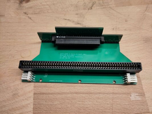

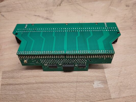

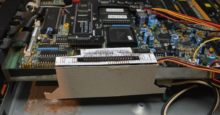

8MB Memory area is in Zll on CIDER, this will slow down the whole machine to 68k speed, there is something other in planning though - let me introduce you a Zorroll adapter for CDTV:
Here is an original Link of this awesome project from Matze:
Will be used to install miniGBAPII++ RTG graphics:
Triton USB card, or maybe LAN - IDE card - that would be great, isn't it!?
Sweet Christmas! This makes me wonder if my CIDER is already obsolete! A few questions, if you don't mind?
  1. Will the Zorro ll adapter for the CDTV allow for a CPU expansion, too? (i.e. will it physically fit together with the TF 536 MC68030 CPU accelerator board?)
  2. Are there any Zorro II-compatible cards out there that are outfitted with LAN/Ethernet and an IDE interface? (I wouldn't want to trade one for the other - I want both true Ethernet and an internal hard disk)
  3. Am I right assuming that the Zorro II-card will somehow fit underneath the CDTV motherboard?
  4. The CIDER board has a killer feature - FlashROM memory. Are there any other FlashROM solutions out there that are potentially compatible with the Zorro ll adapter for CDTV when used in combination with a TF 536 accelerator?
Yes, definitely! Graphic cards like Picassoll needs at least 020 CPU!
  • Are there any Zorro II-compatible cards out there that are outfitted with LAN/Ethernet and an IDE interface? (I wouldn't want to trade one for the other - I want both true Ethernet and an internal hard disk)
Yes, there are! You've probably missed my sale thread?
  • Am I right assuming that the Zorro II-card will somehow fit underneath the CDTV motherboard?
Yes, zll cards are installed underneath the motherboard

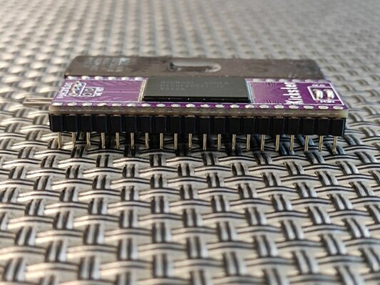

something like this may be used
It's a FlashROM with two Kickstarts in it, that being said - TF536 doesn't work with KS1.3 since this early version doesn't have scsi.device to operate IDE and it can't autoconfig Zlll memory area (TF536 has 64/128MB fastRAM)
