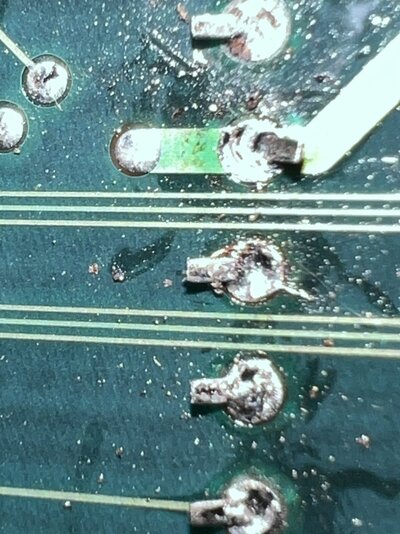

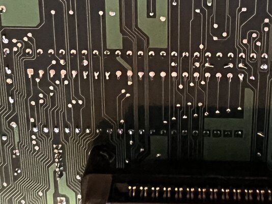

I have taken the board out to have a look. The underneath looks okay

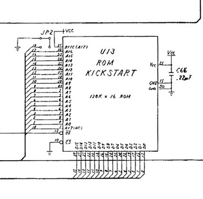

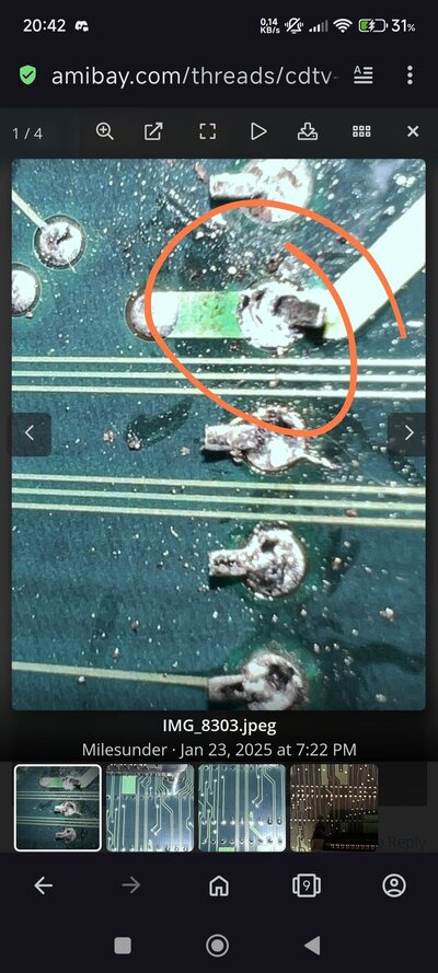

I don't like these Pins at all - please resolder them properly:
also please take a look inside the Kickstart Socket - sometimes traces are damaged there If someone removes Kickstart ROM with a sharp screwdriver..

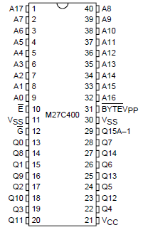

At least two should be at ground .
VSS is ground for the chip .
/E is the enable line ( grounded means that the output is always enabled ) .
/BYTE sets the chip to 8 or 16bit . This is a worrying one , looks like it is set by link2 , according to the schematic .

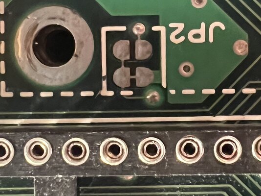

Interestingly it appears I have a jp2 on my motherboard which later revisions don’t have. If I cut the trace would that solve the issue?

looking at the schematic , I don't think that it will . Does that via by the socket go to pin 31 ?
Yes it does. I have cut the trace between the two pads that run parallel to the socket and now there is no continuity on pin 31.
