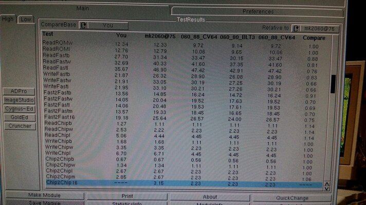

Hi again:) So I've upgraded my MK2@100Mhz and repeated the tests. So now we have results from the single machine:
MKII@75Mhz 1:1
Doom2: 24.7FPS
Doom2 CV64 (320x200): 30.5FPS
AmiQuake (timedemo demo1): 14.3
MKII@100Mhz 1:2
Doom2: 22FPS
Doom2 CV64: 27FPS
AmiQuake 14.4FPS
On the screen you may also see how memory transfers went down. 1st row 100Mhz 1:2, 2nd 75Mhz 1:1. Also @100Mhz the system became a little bit unstable. Sometimes I was able to run the full test, sometimes it failed - mostly because of the heat I guess. Also my results are much lower than @Kawazu which I don't fully understand. Anyway I'm going back to 75MHz 1:1.

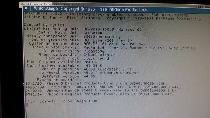

My updated results:
Doom 2 Voodoo3 - 22.6
Doom 2 AGA - 20.8
Doom Voodoo3 - 29.2
Doom AGA - 26.0
Novacoder's AmiQuake timedemo demo1 PAL - 15.2
I downclocked my A4000D to 100MHz (A4000D, CS MKII 68060 @ 100MHz, 1/2 clock jumpered).
Doom2 AGA: 20.4
Doom2 CV64: 24.1
Doom AGA: 24.4
Doom CV64: 29.3
AmigaQuake CV64: 14.3
Novacoder Quake AGA: 16.2
All 320x200.
Olli.

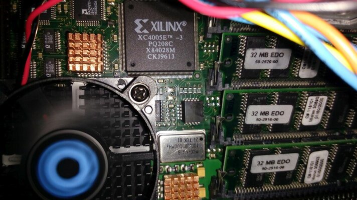

As I got some 72.000MHz cristals, you can also add
MKII@72Mhz 1:1
Doom2: 24.3FPS
Doom2 CV64 (320x200): 29.2FPS
AmiQuake (timedemo demo1): 14.9
Actually it's almost the same as @75 but anyway:)
On 75MHz it was unstable (probably memory issue), but@72MHz it works like a charm.
Hi, I just did this last night as well for one of the members here. Its an awesome mod. I had it running at 80, 100 and 120 just fine. It seems a bit more stable at 100 though and wouldnt want to run it faster than that myself without doing a voltage increase slightly to the CPU maybe?
In any case this card runs faster than my CSPPC now that i have with a rev 6 doing 75Mhz! Crazy!
