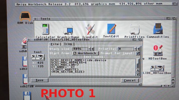

HDToolbox out of the box is set to configure scsi.devices. But, we are going to use the LIDE.device (as we want to use the LIDE.ROM built into the Dicke Olga) to take advantage of the large HD/CF sizes available.
All that is needed to achieve this is to make a copy of HDToolbox and rename it something memorable such as LIDE_HDToolbox.
Click once to highlight the new LIDE_HDToolbox, go to the top menus and select Icon, and go down to Information. The LIDE_HDToolbox dialog box will open. Click on the icon tab and we can now see the one line of text we need to edit (other lines may need editing depending on your set-up, but this will get you started).
Change; SCSI_DEVICE_NAME=scsi.device To: SCSI_DEVICE_NAME=lide.device
Save and exit. PHOTO 1
We now have two HDToolbox’s. One to edit scsi.devices such as the A2091 card, and the new one to edit lide.devices found on the Dicke Olga and DjCook's IDE-CP-LAN card.
We can now format and install/transfer WB 322 onto our new Dicke Olga CF/HDD.
