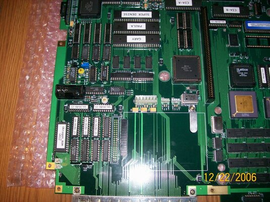

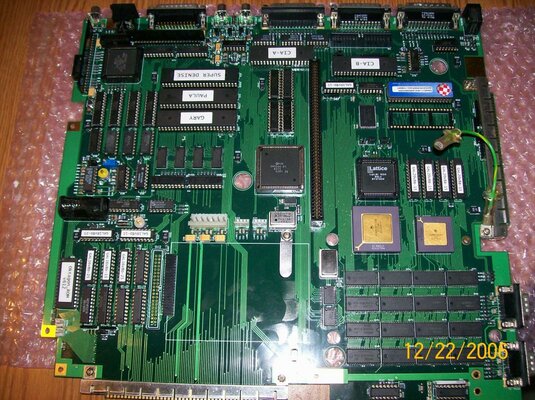

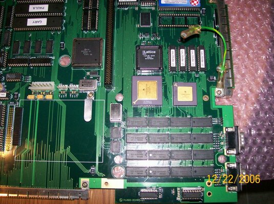

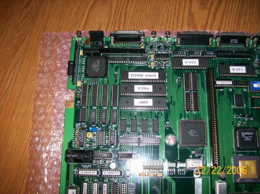

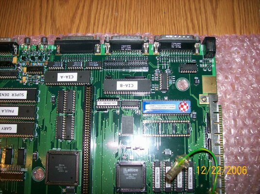

insert a good quality photo of the main, i want look jumper and chip if all are ok
Here are all the pictures, and I did change all the custom chips. But still black screen. Also I can't guarantee that the gals are programed correctly. Because Although they all passed when programed. Trying to read them against what's in the buffer, all I get is error line 1 (0000), so unable to read whats in the chip.....

- S7 has to be closed if there is no card inserted in the zorro II slot...
- I do not see it well but I think you have soldered a resistor on R136 and R128, if it's the case this is also a mistake. Remove R128.
I think it's better to first try through RGB with S2 closed and the oktagon rom out of the board to completely disable the IDE just in case there is a problem there...
It's also better to close S8.
With this fixed, you have more chance to see a kickstart screen. I hope this will help you.
X16 should be closed left if you use a 1000 PSU, otherwise right. There was a mistake in the first documentation's version.
If the board still does not boot, if you are sure from your solder work (for example a short between 2 legs on the Srams could give you this problem) , you should send your set of GALs, Customs IC ans isplsi1024 to someone with a working motherboard who can test them all and reprogram the faulty one if needed....
And I tell you again, some CPU also do not want to boot @50mhz even if they are working on blizzard card @50mhz, there is proof of this @a1k. It's the reason it's better to start to test @40.
It's not so important for now but it's also highly recommended by Georg to solder NE564 directly to the motherboard.....
Your board looks good. :thumbsup:
Thanks for your input I'll try them... OH I do have R128 soldered, and as for the fast ram. There's no solder shorts.. To use a 50mhz crystal, do I have to remove ic78...
and thanks for the comment for my board. Though it ain't no good if all I get is a black screen....
It's probably better to try with a 80mhz with ic78 which will give you 40mhz.
But try first with S7 closed and only R136. Because as it is now, it has no chance to boot I think... And be sure to put x16 on the right side if you have not a a1000 psu. If you are lucky, it will work only with this changes.
You can also try one time with S5 closed, which should give you 0MB of fastram as the flashrom is still empty. And one time with S5 open which should add the 8MB automatically.

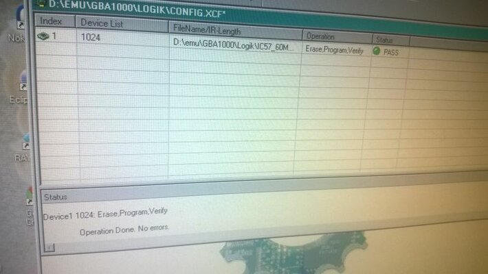

The problem can be with the ispLSI1024 chip. I was testing one GBA1000 rev 4 motherboard that didn't boot, only gave black screen. It turned out that the ispLSI1024 chip was the culprit.
Even though the content of the chip read using a programmer matched the original jedec file, the chip didn't work in any GBA1000 motherboard. After programming another LSI, the rev 4 motherboard booted fine.

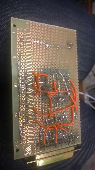

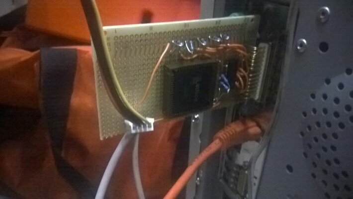

I used the schematic from kudelsko.free.fr to make that ratsnest without planning the layout at all. Should've had some more space around the buffer chip and the ispLSI could've been rotated more optimally :). There were supposed to be 560pF caps in there originally, but of course I had none so I used 1nF... It didn't work so I grounded ispen and connected reset to vcc. Oh and at some point I found that even though there's the same copper traces on both sides of that board, the top and bottom traces aren't actually connected through the holes! But finally I saw that another schematic used only 100pF caps. Before checking if I had any of those, I tried it without any caps - and it seemed to work!

now remember, i used jtag schematic from site kudelsko.free.fr with success with 2 ispLSI1024 for 2 gba1000 but without caps and i modify for use 74hc244
