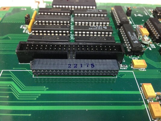

Has anyone got a source for the 2.5" 44-way IDE connector? I've got a straight plug, but really I want a right-angled socket that I can use to plug a drive straight into.

Well, I had a long hard look around and these are pretty hard to find. You could always check auction number 181116298035 on the other bay and see if you like that, it has the correct pitch (I believe) and is also raised the correct amount off the board ensuring easy soldering and that the hard drive will fit correctly (hopefully). It looks like the support pins at each end will have to be snipped off as holes for these are not present on the GBA1000 board.
Somewhat expensive after shipping but looks like it will give the desired effect with a little work.
Looks pretty good, even with the shipping. Will need a bit of cutting and filing though. Unless I can find anything closer to home I'll probably go with that.

The 2.5" IDE connector arrived from the US (www.ebay.co.uk/itm/181116298035) - 4 working days, pretty good.
I did have to hack the sides down a little but looks ok when fitted:
It sits at the perfect level for a 2.5" HDD.
