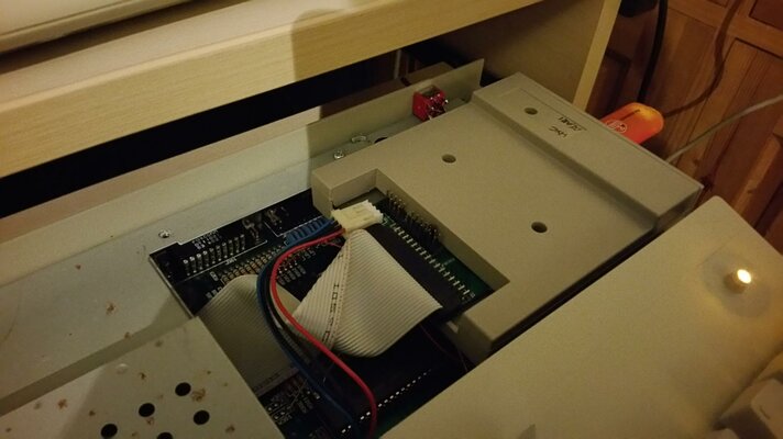

1) I see from http://hxc2001.free.fr/floppy_drive_emulator/ that 1.44Mb is supported on ST but does that mean hardware mods fitted or in models that natively support 1.44 or for ALL STs?
EDIT: Found answer, it seems U do need the mod - http://www.tonmann.com/2014/08/gotek-floppy-emulator-sfr1m44-u100-at-inside-the-atari-st/
2) Expanding on #1 - it says 9/10/11/18 sectors.. what about 20/22 sectors for 1.6+ Mb images?

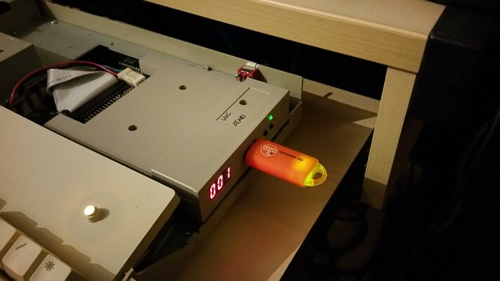

4) Anyone got any links/guides for adding the Text display module (I believe the parts are cheap on eBay)?
