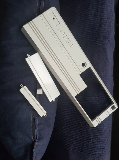

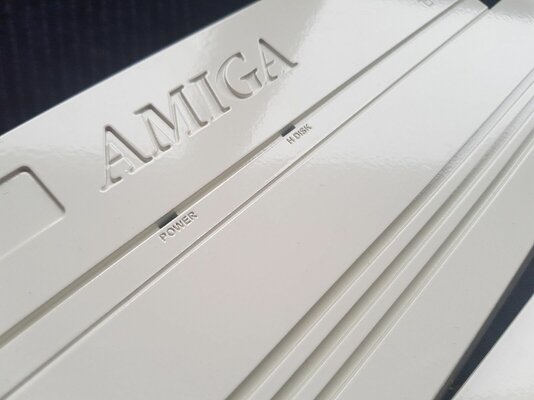

Dear all,
Please find an impression of the quality as provided after coating with RAL9002. It seems the coating is a bit more thick and the fit is really tight, but doable.
FrontPanel details.jpg FrontPanel parts.jpg FrontPanel RAL9002 #2.jpg FrontPanel RAL9002.jpg
Hi
from what i see the surface is now quite smooth and the color looks more like RAL9002
congrats on your efforts obtaining the best result as possible!
The drive covers are a tight fit, it needs some persuasion.
Does it seem like there will be trouble getting a diskette drive or CD-ROM drive fitted? Or is the problem the paint thickness on the drive covers as well?
These look great, by the way! Thank you so much!
