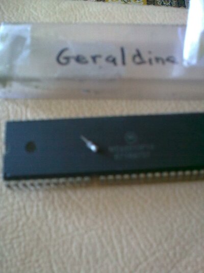

Opened up the packing the 68010 was in and one of it's legs fell out :(

Don't despair! A quick solder job will attach the leg back in to place.
Let me check what pin #12 does.
---------- Post added at 12:43 ---------- Previous post was at 12:33 ----------
Hmm...
Pin #12 is BGACK, , which is an important/needed pin. You can resolder it easily with a minimum effort.
Use flux and a good lead solder.
I think somebody already attempted this because there was already a little blob of solder on it. I think the plastic outer casing needs to be removed a little so that the pin and solder can get a fighting chance of staying connected. Perhaps taking the plastic coating back by a few mil would provide enough space, then I can seal it up again with epoxy.

I am going to have a go at repairing this myself. But I have a question, how far back in millimetres can I remove the plastic cover before hitting anything that might damage the chip further? I was thinking of using a small dressing file to slowly remove about 3 to 4 mil of the cover around the broken leg, soldering it then use a blob of Araldite to seal it up again. If I managed to get this working again, I will be well chuffed, my first real bit of hackery! :cool:

I have experience in repairing these types of problems, A while back I repaired a D2C Wii DVDROM drive by removing some of the plastic coating on the D2C chip and then soldering onto what are essentially leg filaments - the pitch is a lot finer than a 68k moto I can say ;).

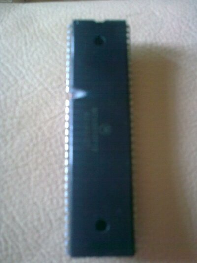

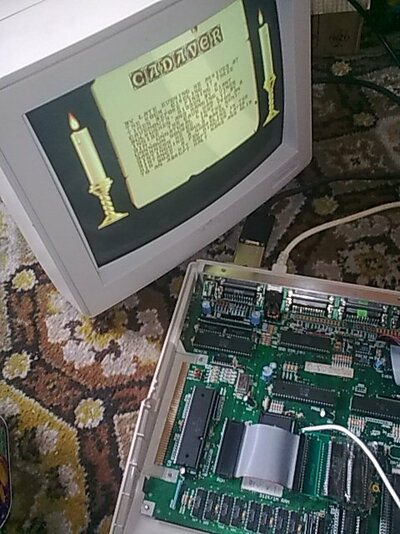

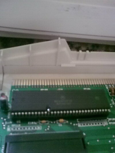

Well I cant believe it, I done it, I fixed it and it works! :blink:
Took ages to remove the plastic coating and quite a few attempts to secure the leg. Quality wise :oops:, Zetr0, Cosmos and others will laugh, but please remember that this was my very first attempt ever to fix a problem like this. Still to finally seal up the join with Araldite, but I am happy! :cool:
Going to replace the battery next with one of Jvdbossc's battery kits and finally wire in my new switch for the ROM switcher. That will be the 500+ finished...........at least for now :roll:
