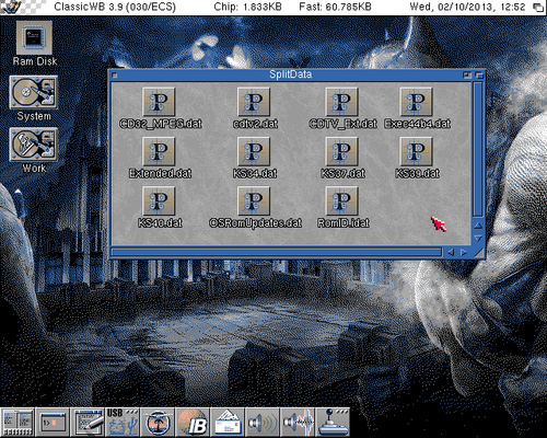

Pablo my friend, you're not doing anything wrong nor you can do anything different from what you do.
In fact and from what I know, RomSplit can't dissect the ROM modules from these Kickstart images because the information on where to dissect each module doesn't exist.
If you check the SplitData folder inside the Remus installation you'll see the following files that are used for dissecting the kickstart images
So apparently we have info for dissecting as following:
- KS34.dat --> All Kickstart 1.3 images
- KS37.dat --> All Kickstart 2.0x images
- KS39.dat --> All Kickstart 3.0 images
- KS40.dat --> All Kickstart 3.1 images
So, sadly (although I don't find a reason why) there is no way to extract the ROM modules from Kickstart 1.2 as we lack the KS33.dat. Who knows, maybe in future, Doobrey can provide such a file :)
