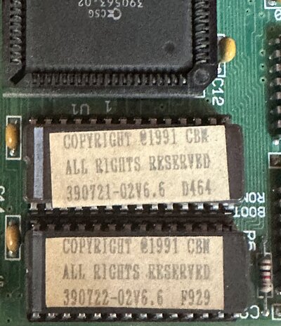

I have one A2091 board with one zuluSCSI v1.1
The A2091 have two rom chips (image attached)
Can I order the GuruROM for my A2091 board ?

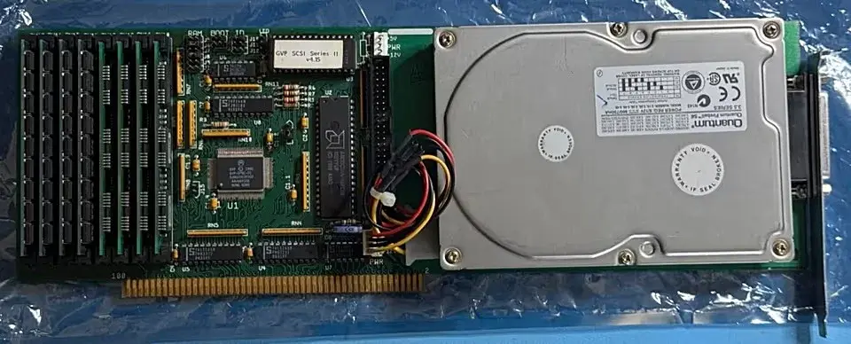

Many GVP HC+8 Series 2 Controllers have a so-called "DTRACK" jumper.
But I have seen a controller with latest 4.15 GVP ROM on which many chips,
e.g SCSI-Chip (long vertical rectangle shape instead of square) are 2 thirds bigger (except the DPRC), resistors have normal size and rings, not as SMD, while that DTRACK jumper is missing.
What is this DTRACK jumper- if present on this GVP card good for?
Does it have any difference or effect on the performance of the controller - and/or together with original GVP ROM or compared to latest 6.16 GURU Rom?
In the meantime I've found out by myself what that DTRACK jumper on some revisions of GVP HC+8 boards was good for. DTRACK is a signal of the Zorro bus.
That extra Pull-Up signal had to be enabled together with some old revsions of A2000 motherboards for compatibility reasons, not for better speed in data transfer.
More info on jumpers and revisions of GVP's HC+8 controller PCB can be found here:
