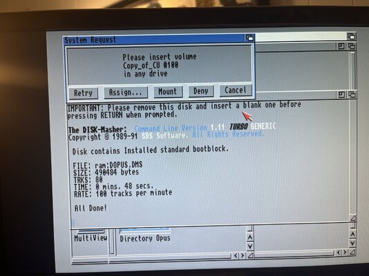

Okay thank you. Another complication. I ran the dopus from the cover disk. First it told me that I needed explode.library. I figured that out. Now I am stuck here. Any ideas? I am running the cover disk on a gotek.

Are you seeing that message after you are attempting to run the Dopus installation file or straight away once The Disk-Masher software has finished?
Try renaming your new floppy disk to Copy_of_CU #100 and trying again.

I am seeing this message after I try to run what’s on the coverdisk adf. I think it’s after the Disk-Masher is done.
I am confused. What new floppy? The .adf I referenced above?
Have you only one floppy drive and when you removed the coverdisk to put the blank one in it needs the coverdisk back in to load something else ? I expanded the disk through Winuae, this is the adf from that archive

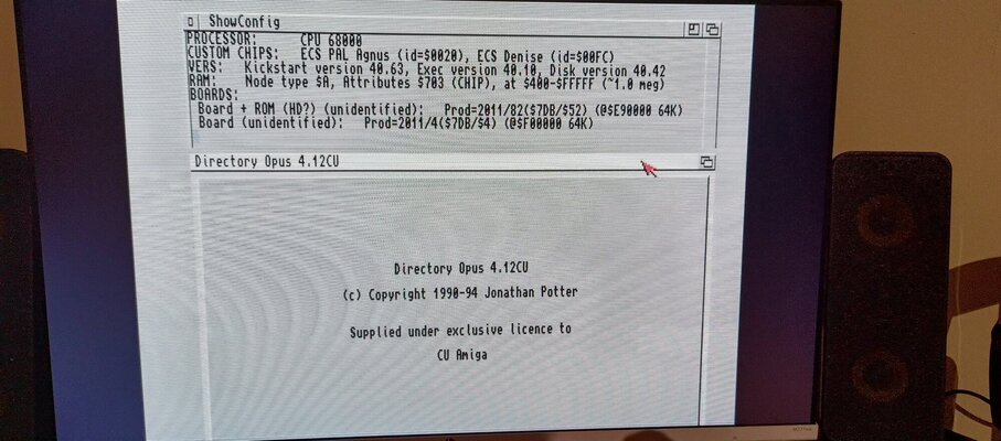

The A500 has the 16BIT 68000 CPU. The later versions of Dopus needs the 24bit/32bit 68020 CPU or above. Unless you have an accelerator in your A500 with a higher CPU, then the versions you have tried will not function as they are coded for a higher CPU. It’s that simple.
The disk adf I attached does need to be renamed to dopus
Then it runs fine on a 1mb OS V3.1 A500
I understand. It’s just everywhere I checked it said versions of dopus 4 work fine on 68000
