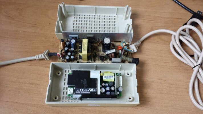

What I did was just to buy a ready made modified PSU from AmigaKit that has the right lead wired in, I have just looked there and cannot see it now, but I'm sure you could find one somewhere. I then replaced the fan with this one and it really is very quite indeed. I have had no problems what so ever powering my A1200 with Blizzard 030/SCSI kit and DSS8+ sampler.

Please take a look here.
Commodore Amiga slim PSU - internal old versus new:
New PSU is rated as:
+5v 8A
+12V 3A
-12V 0.5A
