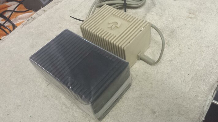

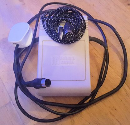

...So here's a little something I knocked up this evening:
-PSU, MiniPSU, and C64 too-

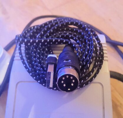

To all intents and purposes it's a 2m braided lead with a usb plug on one end and a C64 PSU plug on the other... with a bit of jiggery-pokery hidden inside. Anyone interested in a how-to? I may be making a few more from spares but: Don't hold your breath.

1) Lop the MicroUSB end off your USB cable and expose about 1.5cm of the four wires within. Trim off the excess outer shielding. Be sure to buzz out which two are 5v and GND, tin the ends with solder. Of the two remaining wires leave one in tact (see later) and cut the other off right at the base - don't throw it away! Tin both ends and keep it for later.
2) Take your MAX660 IC and remove pins 1 and 7 - a little waggle should see them snap off. For the remaining pins only snap the ends off at the shoulder where the thick part comming out of the IC narrows to the bit where you'd normally fit in to a socket/PCB. Then fold the now stubby legs under the IC.
3) The next bit is hard to explain but is fairly obvious with parts in hand. Take each of your caps in turn and fashion their legs in such a way that the longer one looks a bit like a fish hook turned toward the shorter one, the shorter one with very small kink at the end pointed away from the larger...
...Why?
The plan is to solder the two caps to the the remains of IC such that their legs are laying flat on each side of the IC with the bodies just hanging over the end of the IC with the notch. (Um, think testicles! I wish I'd taken a photo)
"C1" needs it's positive leg soldered to pin 2 and negative leg soldered to pin 4
"C2" needs it's positive leg soldered to pin 8 and negative leg soldered to pins 5 and 6
(For more info Google MAX660 and see page 1 of the data sheet. The Positive Voltage Doubler diagram)
3) Take your 5v USB wire (probably red) and carefully expose the copper a few mm above where it exits the stripped-back shielding. Give it bit of a kink at that point and carefully tin that spot. Don't expose too much! Push the (non-testicle) end of the IC up to where the wires exit the cable shielding and then solder the kink to pin 3 of the IC being careful not to short anything. The MAX660 now has power and you still have a 5v wire.
4) Do the same with the GND wire (probably black), this time soldering the tinned-kink to pin 5 or 6 (these are already shorted by the negative leg of "C2")
5) Remember that wire you cut, saved, and tinned both ends? Solder that to pin 8 of the MAX660...
6) ...and the last wire? Wrap that round the length of the IC passing between said testes.
The idea is the IC should now be protruding lengthways from the end of the USB cable with a couple of little gonads closely dangling as if it's a bit of a cold day. The unconnected wire wrapped around the length of the IC to help strengthen it, and three wires (+5v, +10v, GND) kind of adding to the genitalia vibe.
7) Solder GND to pin 2 of the DIN plug, +5v to pin 5, and +10v to pin 6. No further connections are needed and our little gonads should be closely nestled to the circle of pins so keeping things tidy and stopping any shorts.
8] Did you remember to put the DIN plug's plastic shroud over the USB cable before starting?
9) Next reassemble the din plug itself. You should find the electronics fit neatly within the metal bits and the cable poking out as hoped...
...If you find (like me) the metal bit that has the cable clamp is too short to clamp said cable but instead is getting in the way of the IC see below.*
10) Disasemble, wrap the electronics with electrical tape, reassemble, crimp the cable clamp over the cable, and push the plastic shroud in to place.

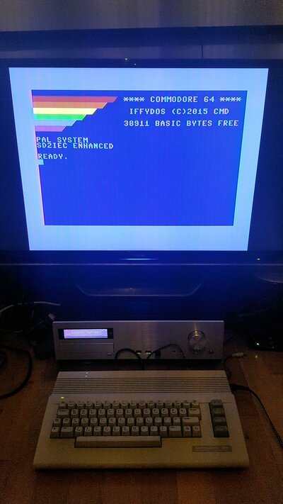

-This 'hack' does seem to work fine with my C64c + SD2IEC + Sound Expander Cart & full keyboard. Good enough for my use case, but is there anything I'm missing to suggest this is potentially worse for my C64c than the OEM PSU?

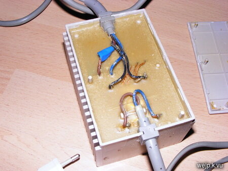

Why are C64 PSUs so, um, nasty... and really hard to replace? Currently, a-hem, mine seems fine but I've read a few scary forum posts that suggest it may not stay that way forever...
Cause most of them are filled with resin so not really repairable once some component goes bad in those things, I've opened a few and this is typical:

You can gouge out a bit of the epoxy, snip the brown and blue wire and install a UBEC inline (this goes in the space you gouged out). Then if the linear regulator blows and delivers 15vDC, this corrected back to 5vDC before it kills your DRAM. You can pick one up for about 2 us$ incl. postage from China.
Alternatively you can remove the whole epoxy block and reuse the case for a 9vAC transformer and a switching 5vDC "buck" regulator. See here.

I am curious to how you got your C64 to boot like a c65?
Sent from my iPhone using Tapatalk Pro
Hi,
My C64 dual boots between the standard OS and a Frankenstein's creation made of the DolphinOS kernal that's had it's FDD routines swaped for the JiffyDOS ones as I like Dolphin but use an internal SD2IEC. The boot screen has indeed been modded to look more C65ish.
I can't claim any cleaverness for these mods. If memory serves I've got another C64 thread on here somewhere regarding how I did it and who's ideas / code I nabbed.

Hi all
Ive been playing with charlies usb>C64 psuthingy and so far, all is good.
My C64 is a short board C64c, has a pseudosid board with a 8580 and a nanosid. Also a chromafixer board and 1541U2 cart.
+ to Spanner's helpfulcomments re beachhead, which as predicted loads but doesnt appear to run. Not sure what else to test it on, but wizball and ghostbusters and the usual suspects all work, with the plug staying cool after a few hours soak. sid sounds fine.
I'll be adding my tapuino to it next.
