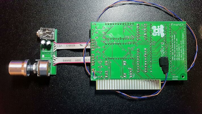

MockingBird V2c and Egg
Installed and Back Panel

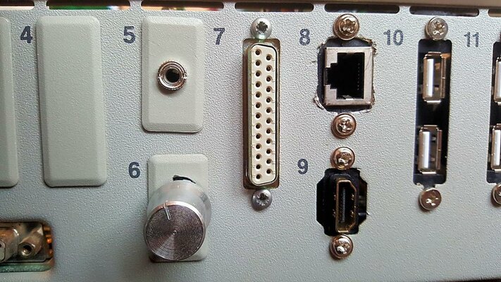

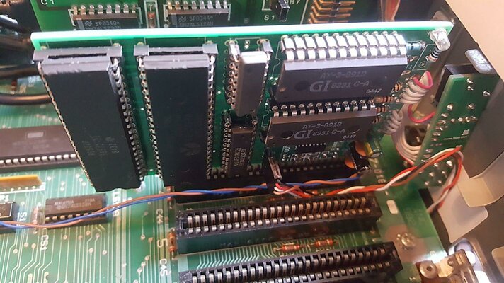

So here's the (nearly) final-final version of the AY-3-8913 MockingBird. I can report it works perfectly, and the port mounting solution fits exactly as intended - genuinely surprised by that as I did the measuring using "#1 eyeball". I even seem to have picked the right volume control pot for it: *Edit* 2k, not 5k *Edit*, non-linear. The sharp-eyed will spot a 3k resistor in place of a System Sound - MockingBoard mixer pot, that's just because I currently don't have any and 3k seems to work well. I also seem to have run out of 6522's, spot the ancient MOS one I dug out of somewhere... *cough*
Why (nearly) final-final? Well, this is my V2c board but I've done a V3 in Eagle. The latter is functionally identical but has the IC's placed in a more pleasing arrangement, and also comes in a Yamaha flavour too... I need to do a mock-up of the latter when my YM IC's finally arrive to be sure it works.
So very nearly ready to go in to proper production: The Mockingboard is (nearly) available once again, an shouldn't be at the usual eye-watering price even retro Apple kit seems to go for. :)

For info I've taken to soldering the amp module direct the the board without any issues. Specifics:
-Sticky label on back of module (not covering the pin holes) to prevent any (small) risk of shorts with the main PCB
-Fill one of the pads on the Mockingbird PCB with solder and the same for the equivalent pad on the Amp module
-Place Amp module carefully in position and apply soldering iron to previously filled pad
(the two pads will melt and weld together)
-Repeat the process for the rest of the pads
-Check continuuity
Call me silly for not considering this before, but this is much neater / more convenient than using headers to attach the two as I did before.

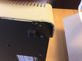

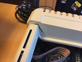

the vendor asked me to return it in order that he might fix it.
I packed it up and did just that.. parcel force damaged it in transit ..
I'll attach a couple of pics to show what was done..
The vendor was most appologetic and is seeking compensation...and in the meantime has offered a full refund if I want it.
OR ..he is expecting another 2 weeks from the incident ..and my name would be on it ..plus he will also bundle some free software to compensate me for the distress and wait.
I agreed to the latter..having spoken at length to him on the phone.
He is genuinely upset about this ..and understandably so.
I'm sorry to invade your thread with this..but thought you might be interested in the saga..

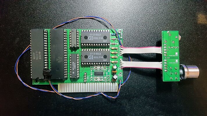

i have assembled my mockingchick. yay!
It's in slot 4
Load choplifter... no mockingboard sound. ah.. I'm using powered external speakers.
ballblazer outputs regular apple 2 sound vis the internal speaker still, and the apple still beeps ok on boot.
Please name a test disk and or how to test this ? thanks.
in other thoughts:
1 I have mounted the amp board using pins instead of wire clippings as was neater. However I mounted the board, then found I couldnt solder one row of the AY's in as covered by the board, i think the instruction steps are back to front at that bit :)
2. am I supposed to add 5v in to the amp board as well? I'm not clear how to hook things up from now on, and if I want to use the internal cone speaker for left channel Ay sound, and add a second cone speaker under the keyboard for right channel. is that possible?
3. I've taken the board out to clean the flux off.. so I can hopefully try again in the week
4. lastly charlie, your boards are psychotically small! getting the 3.5mm jack in the rear is difficult. You boards meet the 'as small as possible' brief quite perfectly ;) :)
You Don't need to add additional 5V ;)
You can Use the internal speaker for the one channel absolutely but it must be connected ONLY to the Mockingchick and feed the Mobo's Sound Out to the Mockingchicks external input pads :)
