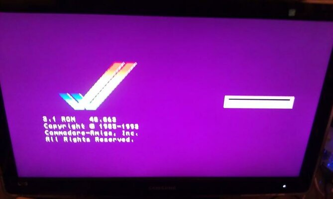

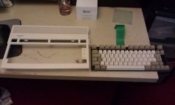

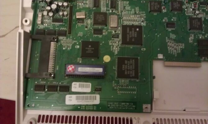

Recently I bought a very nice A600 from Fitz Steve and set about expanding this little baby into a good little WHD Load Machine :thumbsup:
At present the little miggy is in bits at the moment after the case had a deep clean with Glow White and Persil.
In the mean time I have purchased some upgrades from you guys on Amibay :bowdown:
Thanks to Sardine for the 6.4gb Hard Drive and William for the 1mb of Chip Ram which is speeding it way to me :D
Also arrived has a 3.1 Rom from Amiga Kit which has already been installed :),also a 2.5inch HD Cable. From EBay I got a 2.5 to 3.5 converter cable to hook it up to my PC to create my Workbench Installation in WinUAE before placing in my miggy :D
I have uploaded some Pics to show you all what stage my WHD Load A600 is getting on

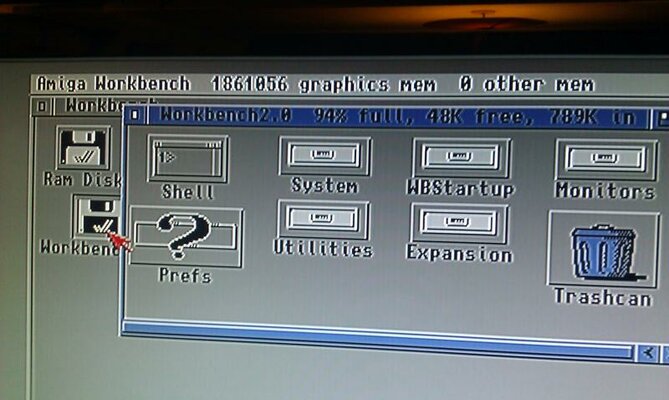

Just to keep you all updated I have received and installed the 1mb Chip Ram from William and it has worked a treat :thumbsup:
Now to get that HD Sorted this weekend :unsure:

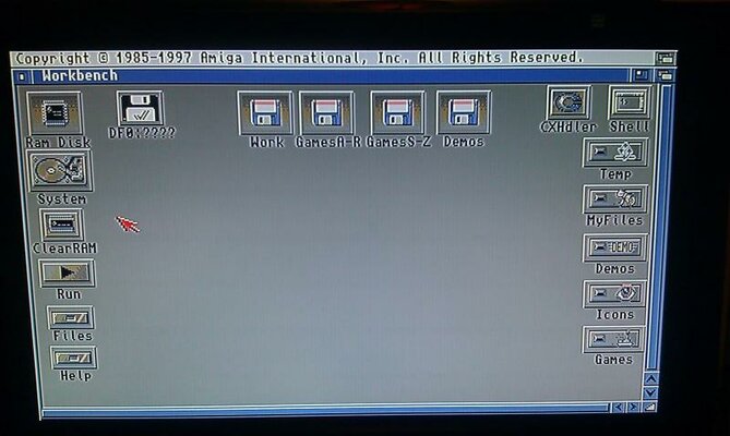

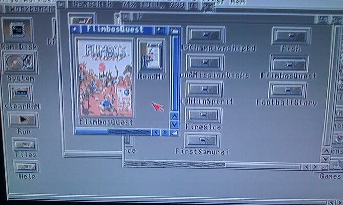

Made some progress this weekend :thumbsup:
After having issues partitioning the 6.24gb HD in winuae I eventually sorted that by using the clean command.
Installed Classic Workbench 68k edition on the HD.
A600 found the HD straight away and booted into Classic Workbench - Result!! :D
Thanks Steve for the great vid - really helped - Just transferring all my WHD Load installs via WinUAE onto the miggy HD.
Images to follow

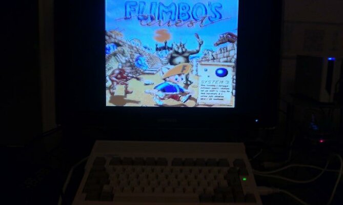

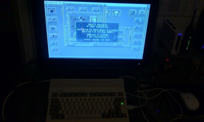

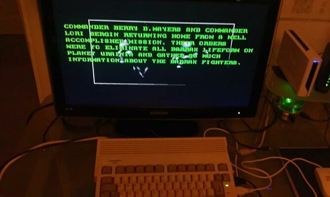

Well I have done as much as I am prepared to do today lol
All my WHD Load Games and Demos have been transferred :thumbsup:
Loaded a few low memory games - worked :thumbsup:

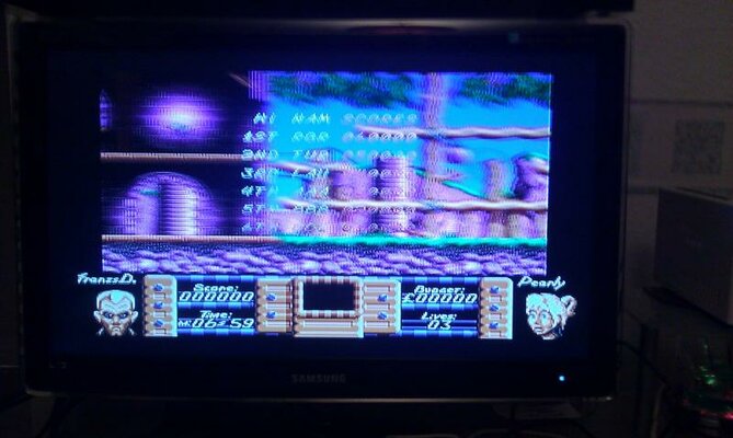

Might of made a slight boo boo though I might of messed up the chip ram as the picture glitches from left to right and back again :Doh: :oops:
Tried without the chip ram and there is no glitch
Anyway some images below

Any thoughts on why the screen is glitching from side to side with the chip ram?
Think I might of damaged it when I have been installing today :Doh:
Thanks in Advance as always buddy
