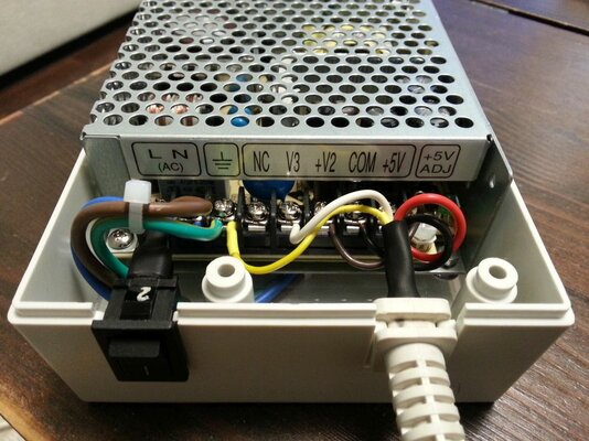

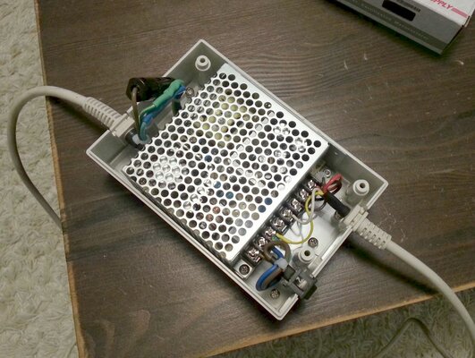

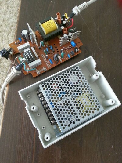

Decided to do one more mod... I recapped the PSU earlier but decided to ditch the old PCB and upgrade it with a modern switching mode PSU, Meanwell RT-50B. It has great specs for Amiga and actually I found Rubycon 105C caps inside... Anyways, it fits nicely in to the Amiga PSU enclosure:
Had to make adapter to secure PSU into Amiga PSU enclosure without additional screw holes:
Fits very nicely and no wiring mess expect that I had to extend mains wires since originals were too short. I extended mains wires instead of secondaries so I was able to fix "design flaw" - power switch being on the back of the PSU!
I think results are great? Only problem is fuse holder, it's too big and clunky. Need to find smaller one.
