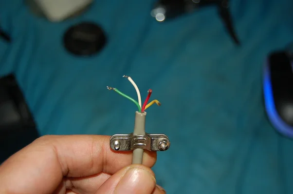

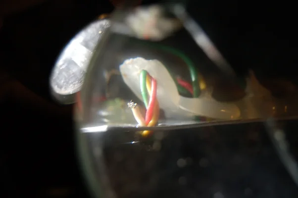

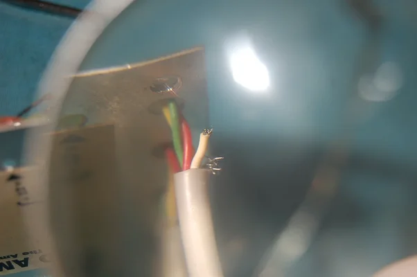

I need an Amiga Analyzer fixed. One 9 pin socket needs 2 wires soldered in pic labeled 1. Another has an entirety missing pin socket on pic 2. They both need socket covers too. There's one more that has a white wire idk where it goes in pic labeled 3 & 4. I tried to see where the other end of that white wire is and attaches to but can't find it at all.
