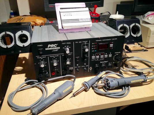

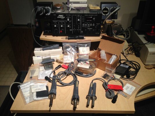

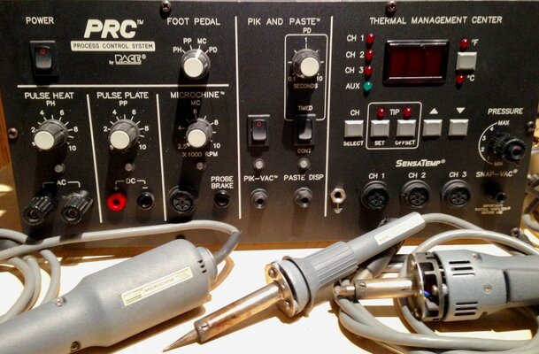

Picked up another lot deal from a Canadian seller; this time I managed to get some power supplies (2 with snap vac) to pair up with all the spare hand pieces I've got kicking around. After this I'll definitely need to start bundling some of the spares into sets for sale
Lot included 2x model PPS-85 three-channel digital stations; which is why I grabbed it -- if even just one of them worked it was worth the cost of the lot, and luckily both appear to be functional

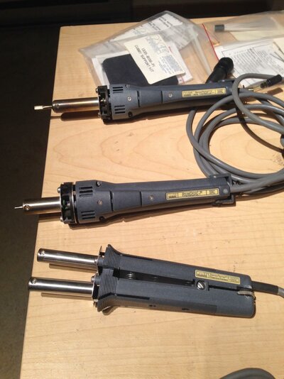

The other two PACE supplies are basic analog models; the two channel one doesn't actually contain a vacuum -- it just has a pass-through air port. Additionally there's a Weller WTCPT, a set of OK Industries hot tweezers, and a bonus item which wasn't readily visible in the original listing photos which turned out to be an electric screwdriver.

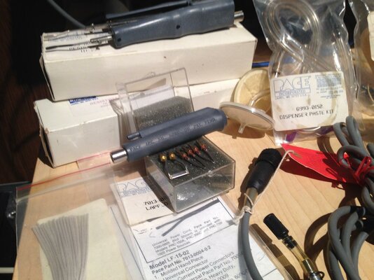

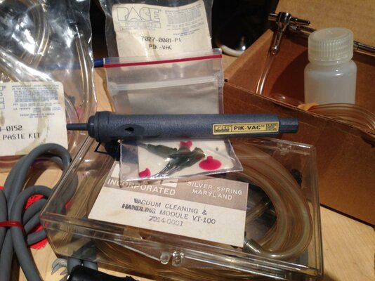

Included PACE tools were: 4 irons (SP-2A, 2x PS-70, PS-80), a TJ-70 ThermoJet and 2x TT-65 Tweezers. Also included was an SX-70 Sodr-X-Tractor which had a broken handle and heater mount, but since there was a TP-65 ThermoPik included too (not pictured) I quickly pilfered parts from it to refurbish the SX-70
Interestingly one of the PPS-85 had an unusually strong vacuum but no air output; and it was much louder than the other MBT units:
After taking it apart I found that someone had replaced/modded the pump (based on service manual schematics) with a newer replacement meant for the PRC-2000. Some of the air lines had become disconnected so I re-connected them and tried it again; but the output pressure was so high it kept blowing the hoses and filter apart.. I ended up having to remove the outflow filter and replace and zip-tie the pressure port hose so that it could handle the extra force. I've decided to put this one on the bench now in place of the analog PPS-80 since it's an absolute champ at extracting solder with that pump installed
