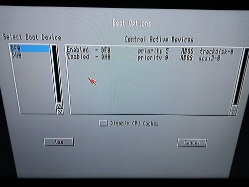

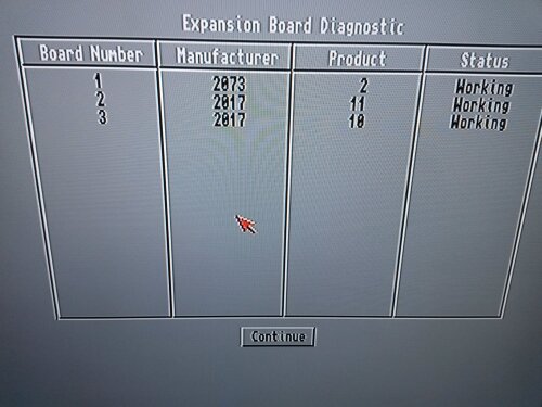

Currently I have three different SCSI cards (an A2090, a GVP Impact A2000-HC and a Kupke Golem SCSI II), but as I have figured out, they are relatively old - especially the A2090 - and I couldn't make them
work with the 3.1 ROM + 4GB HDD setup. All three cards look undamaged and show up as Working in the early startup menu, but cannot detect the attached SCSI HDD with their setup utilities.
If either the GVP or the Kupke card should work in my system - with the aforementioned setup - somehow, please inform me how.
If not, then my plan is to swap these three cards for a more modern one.
That card doesn't need to have RAM expansion abilities, because I'm planning to add FastRAM to the system via another Zorro card.
It should however support "big" hard drivers (at least 2GB ones, 4GB would be optimal), and should have no problem with the 3.1 Kickstart ROM.
Any advice appreciated.
