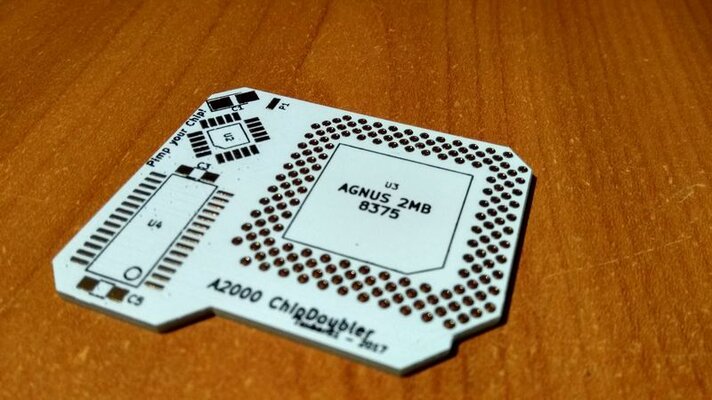

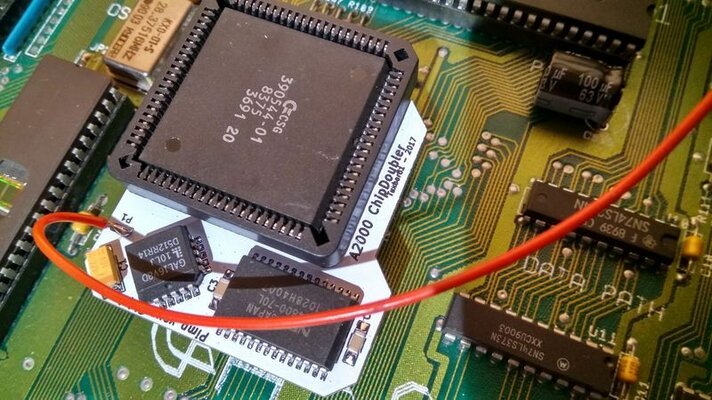

Here is the launching of the Megachip project for the A500. The particularity of this version is the connection method.
Habitually, the Megachip is plugged in the PLCC support of the AGNUS chip of the Amiga motherboard.
To connect this new version, the PLCC support of the motherboard must be desoldered.
To intall the Megachip, two solutions:
- The Megachip is soldered directly onto the motherboard. This solution allow you to install an accelerator board in your A500!
- The Megachip is plugged onto a 84 pin PGA socket which is soldered on the motherboard. With this solution, the Megachip isn't soldered on the motherboard.
But the use of an accelerator is not possible due to the height of the Megachip.
The use of the Megachip works fine in an A500 rev6. I actually don't know if it's possible to use it on other revision of A500. I have to take a look at the pinout of the AGNUS used on older revision of the A500.
Here, some pictures of the Megachip installed into an A500 rev6:
View attachment 122685 View attachment 122683 View attachment 122684
The Megachip plugged on a PGA socket:
View attachment 122686 View attachment 122687

Which AGNUS do you need?
The board is designed for the AGNUS 8375. It has been tested with the revision 390544-01 (PAL). As the pinout of all 8375 revisions are the same, the Megachip should run with all of them. List below from a post of fordav1:
Agnus (2MB) 8375 R0 318069-18 A500+ (PAL), A600 (PAL)
Agnus (2MB) 8375 R2 318069-10 A500+ (PAL), A600 (PAL)
Agnus (2MB) 8375 318069-11 A500+(NTSC) and A600(NTSC)
Agnus (2MB) 8375 318069-19 A3000 (NTSC), A3000T (NTSC)
Agnus (2MB) 8375 390544-01 A500+ (PAL), A600 (PAL)
Agnus (2MB) 8375 390544-02 A500+ (NTSC), A600 (NTSC)
Onto which Amiga this board works?
The design has been made of the A500 rev6 motherboard.
The electronic design works onto the A2000 but the geometry design is not adapted for this computer.
The routing for the A2000 version is done.

About the Megachip for the A500, I have tested to route a version for using a hole-PLCC socket. I don't like the result. I'll stay onto the smd version of this board.
About the Megachip for the A2000, I have produced some pcb. I have assembled one of them (with a really professional attention...). I can annonce here that this version works perfectly!
Here, you can see some pictures of the A2000 version of the megachip:
For this version I have found the high quality PLCC socket (3M) for a very good price. I have bought 57 pieces... all the stock of the seller.
Somebody, who is member of Amibay, has contacted me on my email to proposed me some AGNUS chips also for an interesting amount (15€/piece). As usually, I'll make no profit on them. Perhaps I'll have to count the custom taxe if I can't avoid it. I should have between 40 to 50 pieces. I want here to thanks a lot this member for his kindness.
It's not the last revision, but it's a really better price than the ones proposed by a dark member here who has contacted me by PM to proposed me his "secret" stock as he said for the really friendly price of around 30€/piece... Voilà voilà.
I have to verify, but the A2000 version should be sold assembled for the same price as the A500 version. Always low price to be accessible for everyone! High price doesn't mean professional quality, and low price doesn't mean amateur quality.
