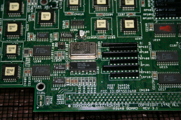

Okay Arnljot. Is the card slik Screened as a 3.1 (Along the CPU connector edge) with GAL chip U209 ending - 02? (Top Left area of card with CPU Connector nearest you)
For reference Pic, see the Pic here on TC's Thread....
Linky
In the Pic, U209 Gal chip is the one in the bottom right corner of pic. That ends -01 & is normal for a Rev 3.0 A3640.
A Rev 3.1 A3640 is silk Screened 3.1 by the CPU Connector but U209 will end -02.
A Rev 3.2 A3640 is Silk Screened 3.1, but U209 will end -03!
The other GAL Chips might also be different revisions depending on the overall revison of the A3640 & Anthony Hoffman is probably your best bet for the Tech! :wink:
Kin

Also there is the version printed on the board, near the socket.
Aha! I do have a 3.1 board :)
So: For some reason the sticker on my U209 has been removed. So the text on it not indicative of the version. But I think it's safe to assume it's a v3.1 card. It could be version 3.2 but that is unlikely. Just as it's unlikely it's v3.0, since it's silkscreened v3.1
Re: Q:Commodore A3640 tinkering - Watch out I have boing balls!
Great stuff Arnljot. The label probably came off with Age & heat. They literally curl up with age!
I guess you dont want my 40Mhz XC 040 to run it cooler @ 33Mhz! :?:
Heres a Pic of a 3.2 - TC owns this now! - Any Help for you?
You're only concerned with the numbers after the dash. (-) :wink:
& as rkauer so elequantly puts it, GAL are better than PAL even though my old Rev 3.2 has PAL chips fitted! :lol:
Kin
*edit*
The Pic rkauer shows with a jumper wire is NOT needed, though I'm sure someone with the tech. knowledge can explain why?
