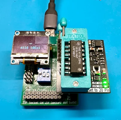

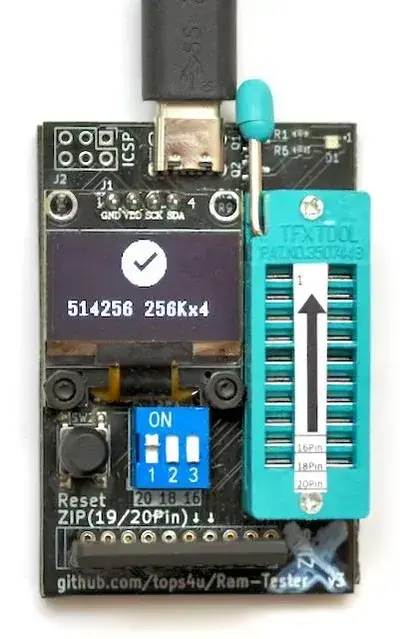

RAM Tester for Commodore 8-Bit, Amiga & Retro Systems
Featured in Hackaday & Elektor Magazine
Fast, precise, open-source DRAM tester for classic CBM RAM chips found in C64, C128, Amiga (500/1000/2000/3000/4000), Atari, Apple IIe, ZX Spectrum, BBC Micro and many more vintage systems.
Key Features:
- Tests 20-Pin ZIP RAM (DIP and ZIP packages)
- Verifies Static Column functionality
- Measures actual retention time (2-16ms depending on chip type)
- Complete test in under 15 seconds
- One of the fastest Arduino-based solutions available
Current V3.4 Hardware (all revisions are software compatible)
Open Source Hardware & Software
This is an open-source project – schematics, PCB files, and firmware are publicly available:
GitHub: https://github.com/tops4u/ram-tester
Build your own or order a partially assembled kit from me.
Two Versions Available:
  • Through-Hole Version (Micro USB power – ideal for DIY builders)
  • SMD Version (compact, USB-C power)
Kits sold here are the SMD USB-C version with all SMD parts assembled, programmed and tested. You only need to solder the through-hole components (ZIF socket, Display, DIP switches, ZIP sockets).
What Makes This Tester Special
Most Arduino-based DRAM testers need 2+ minutes for a single 41256 RAM and check only basic functions.
This tester completes a comprehensive test in 15 seconds or less including:
- Memory cells with various patterns (each bit tested at least 6 times)
- Crosstalk testing (rows & columns)
- Address lines & decoder verification
- Retention time checks (row-wise, twice with random data)
- Ground shorts detection
- Static Column functionality
- Fast Page Mode functionality
- Row Refresh functionality
- Refresh Counter functionality
Speed Comparison:
Other Arduino testers use slow DigitalWrite commands (4µs per bit = 100µs minimum per cell).
This tester uses direct port commands (62.5ns for 1-4 bits) making it up to 60x faster.
Supported RAM Chips
DIP Package (16/18-Pin in ZIF Socket):
  • 4027 (4K x 1) - 2ms retention test (requires adapter board)
  • 4116 (16K x 1) - 2ms retention test (requires adapter board)
  • 4816 (16K x 1) - 2ms retention test
  • 4164 (64K x 1) - 4ms retention test
  • 41256 (256K x 1) - 4ms retention test
  • 4416 (16K x 4) - 4ms retention test
  • 4464 (64K x 4) - 4ms retention test
  • 411000 (1M x 1) - 8ms retention test
  • Preliminary 4532 / 3732 (Half-Good 4164 used in Spektrum)
  • Upcomming Nibble Mode for 41257
DIP or ZIP Package (20-Pin):
  • 44256 / 514256 / 514258 (256K x 4) - 16ms retention test, Static Column support
  • 514400 / 514402 (1M x 4) - 16ms retention test, Static Column support
For a complete compatibility list including specific computer systems, see: GitHub Compatibility List
Test Times
All times from reset to completion with display enabled:
  • 4027 / 4116 / 4816: 2.9 seconds
  • 4164: 4.6 seconds
  • 4416: 3.9 seconds
  • 4464: 6.7 seconds
  • 41256: 12 seconds
  • 514256: 5.9 seconds
  • 514258: 6.2 seconds
  • 514400 / 514402: 16 seconds
  • 411000: 37 seconds
Safety & Ease of Use
Protected:
Resettable fuse protects the tester if a chip shorts out

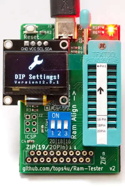

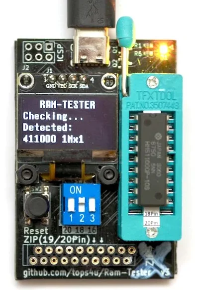

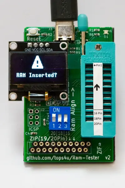

Simple Operation:
  1. Select chip type using DIP switches (16/18/20 pins)
  2. Insert chip into appropriate socket (ZIF or ZIP)
  3. Connect USB power
  4. Press reset button
  5. Read result:
    • Yellow LED: Testing in progress
    • Green + Yellow flashing: PASS
    • Red + Yellow flashing: FAIL
    • Display shows detailed results
Demo Video:
Watch the tester in action on the GitHub project page (link above).
Documentation & Resources
Complete documentation available on GitHub:
  • Assembly Instructions: GitHub Docs Page
  • User Manual
  • Schematic & PCB files (KiCad format)
  • Firmware source code
  • Changelog & updates

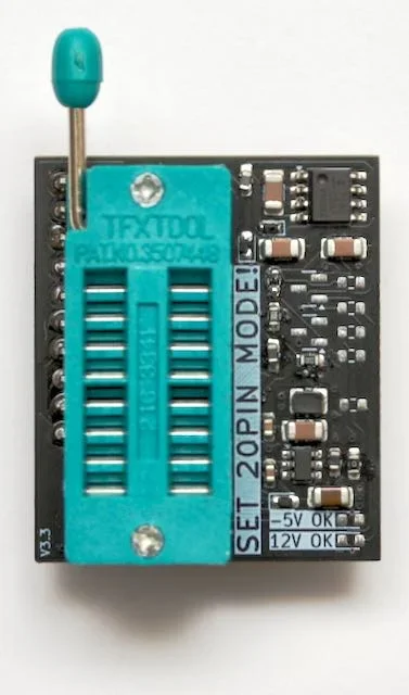

4116 Adapter Board
The 4116/4027 RAM chips require special voltages (+12V, -5V) that the main tester cannot provide. An optional adapter board is available that:
- Generates required voltages safely (current-limited to approx 30mA)
- Includes LED indicators for voltage presence
- Features latch-up protection
- Designed for safety with sensitive 4116 chips
Price & Shipping
  • RAM Tester Kit: 25 CHF
  • 4116 Adapter Board: 10 CHF (requires main tester)
  • Shipping:
    • Switzerland: 2 CHF
    • EU: 4.50 CHF
    • Worldwide (except USA): 7.50 CHF
    • South America: 14 CHF (registered mail only)

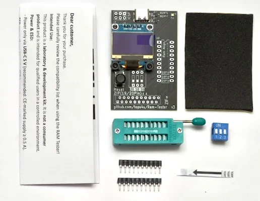

What's Included:
  • PCB with all SMD parts pre-assembled
  • Programmed and tested ATmega328P microcontroller
  • All through-hole components (ZIF socket, OLED display, DIP switches, ZIP sockets)
  • Assembly instructions leaflet
  • Self-adhesive foam rubber pad for completed PCB
What You Need:
  • Soldering iron (50 solder points total, 36 for 4116 adapter)
  • USB power supply: 5V 1A with USB-C cable
Note: Orders ship from Switzerland. Import duties and/or VAT may apply depending on your country.
