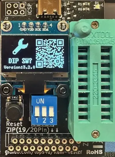

Preliminary v4.0 Firmware is available.
4532/3732 Code unverified, since I don't have the RAMs to check and tune the code. All the rest ist tested and working.
Source Github as usual.
Excerpt from the changelog:
v 4.0 (2026-01-11)
  • BREAKING: 4164 RAMs are now tested with 4ms Retention time. There are few 2ms 4164 around and most Computers will need the 4ms Part.
  • Added QR Code to help you find the GitHub Docs Page in case DIP Switches are invalid
  • Added Selftest/Healthcheck Mode. When all DIP Switches are OFF it starts automatically. Check Documentation on how to use
  • Added CBR (Cas-before-Ras) Timer Test. At the End, for RAMS that have a Refresh Timer, it is now tested
  • Preliminary Support for 4532/3732 RAMs. This is UNTESTED and most probably still buggy. All other RAM checks should be fine
Peek-Preview for the next Firmware Version.
  • 🆗 Most probably I'll include 4532-L and 4532-H support ;-) -> Implemented but untested / maybe buggy since I don't have such RAMs (yet).
  • 🆗 Also there will be more "Online" Help when someone dials an invalid DIP Switch combination, by presenting a QR Code that leads to the current documentation (See Image). -> Implemented
  • 🆗 Maybe (if I can free some more Flash Memory) I'll include a Self-Healthcheck of the Tester. So if you are not sure that the Hardware is ok, you can run a Test. However I'm hitting the limits of the Controller (Flash Storage) so this is a 50:50. --> Implemented.
  • 🆗 If the Self-Test does not fit, I may opt for a Test that (AFAIK) few in this (price) class have done, It will include the Test of the Refresh Counter for Rams that support it. Actually I have only found one product who claims to check this. --> To do, but since I have freed additional 2k of Flash it should does fit!
