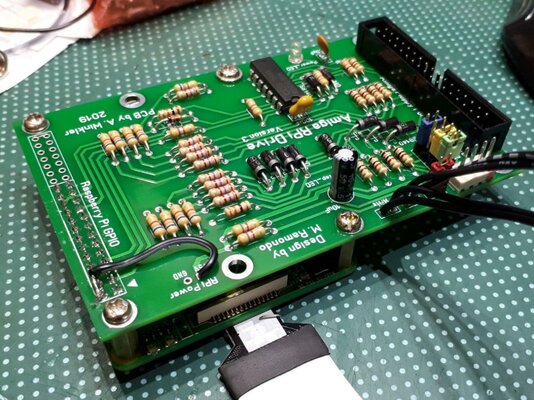

I have made a few PCBs for Maurizio's Raspberry Pi Drive.
Just tested with my Pi Zero and A+. Both work fine.
The PCB is designed to have either Pi version attached below with 10mm spacers.
Up to 4 drives (DF0-DF3) can be enabled/disabled via jumpers.
The Pi can be powered externally or from the PCB (with a wire).
If anyone is interested please let me know. I could provide the following options:
1. PCB only [20EUR incl. intl. shipping]
2. PCB and all the parts for self-assembly (DIY solder kit, excluding Pi) [35EUR incl. intl. shipping]
3. completely assembled PCB (excluding Pi) [55EUR incl. intl. shipping]
4. completely assembled RPi Drive (including Pi Zero and pre-installed MicroSD card) [85EUR incl. intl. shipping]

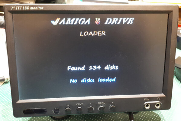

Furthermore, I got the "Amiga RPI Drive Video" version of Maurizios software to work on my Pi A+. This means I can connect a monitor (via HDMI or composite signal) as a status display to see what the system is doing and which disk images are loaded/loading currently. This is additionally to the standard Amiga side display, which is the interactive part of the software.
screenshot of the external loader screen
