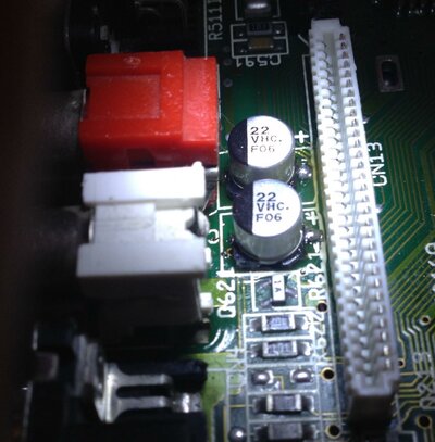

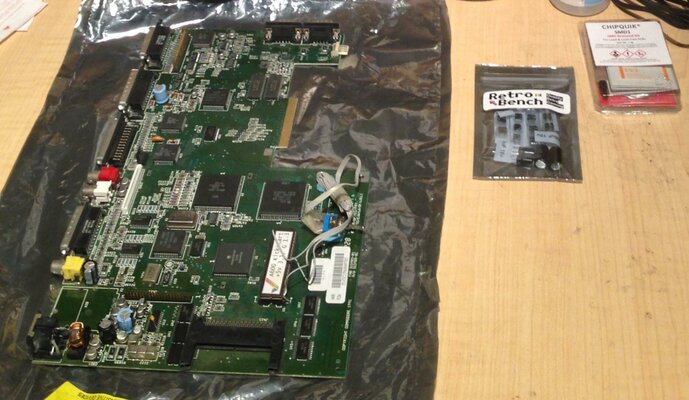

After re-capping my A4000 I inspected some of my other systems, the A600 was looking particularly leaky so it was next up for repair.
Instead of the "gentle mechanical removal" method from before, this time I decided to try using ChipQuik.

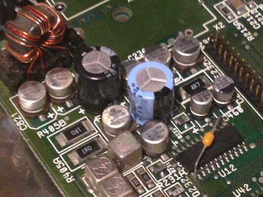

Taking a close look at the power input capacitors it's clear that most everything has leaked, plenty of dull or darkening leads, corrosion and residue:
Others fared better, but still some corrosion on a capacitor known for causing timing problems and cloudy leads on the others:
ChipQuik usage was fairly straightforward; it's brittle so it's easy to brake off a small segment with tweezers and drop it in a blob of flux on each of the capacitor leads. Touch it with the iron for 2-3 seconds and it pulls itself into the old solder. After that you can re-heat quickly and have several seconds to remove the part easily.

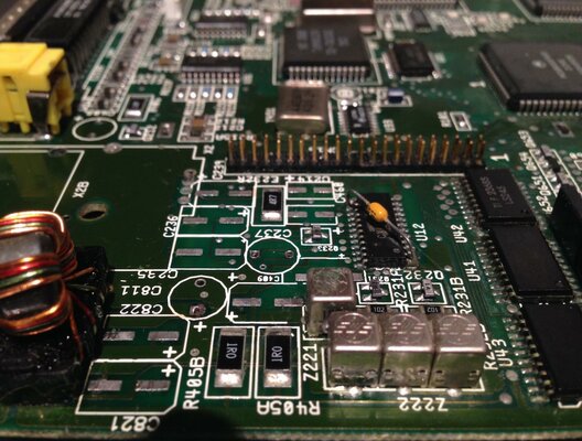

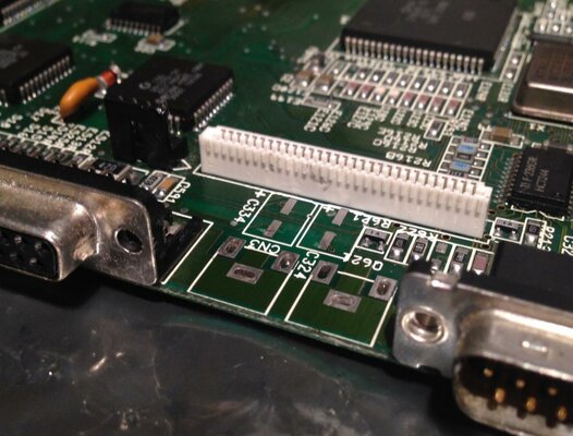

Here's the power input and audio areas de-capped and cleaned up -- cleaning just requires re-heating and wiping away with a bit of flux on a cotton swab while it's still molten for a few seconds:

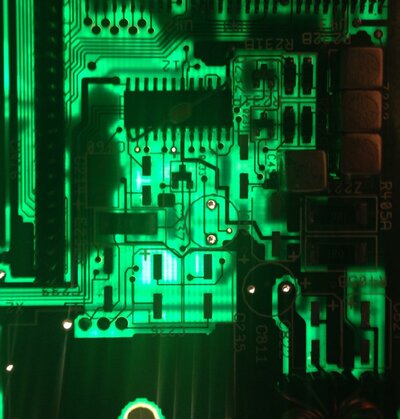

Inspecting the traces in the heavily corroded areas, all appears good:

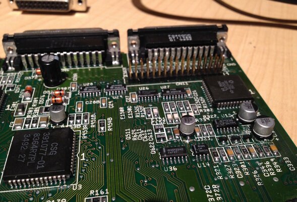

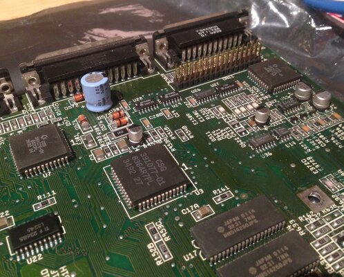

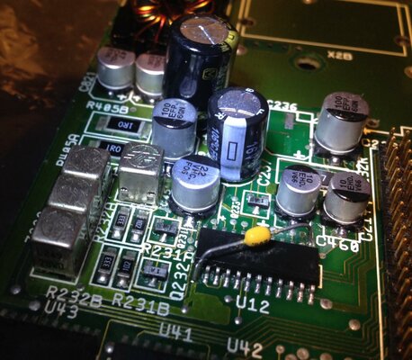

Capacitors replaced; put a bit too much solder on the pads + the iron tip and it bubbled out a bit when pressed down; a few have nice fillets but will definitely have to hold back on the solder a bit next time. All connections at least appear solid and measure sanely with the meter.
One of the pads in the power area had lifted with some corrosion underneath and I managed to snag it on a cotton swab while cleaning :hammer: -- Luckily the capacitor and it's neighbour just lead to a dead end where the RF modulator used to be.. :whistle:

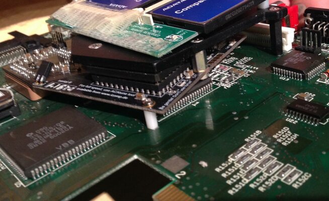

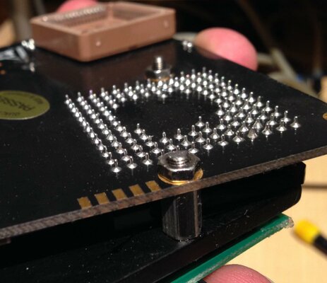

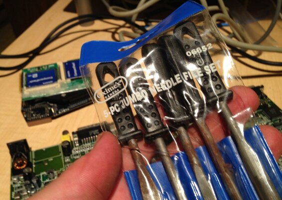

First up I put the ACA630 back in the system; doesn't seem to want to sit flush and won't detect on boot -- so I decided to take a closer look:
Hmmm.. Nope; that doesn't look right..
I think I have a tool for this..
Much better, sits flat and 68k socket on the ACA630 now sitting flush to the board on all sides:

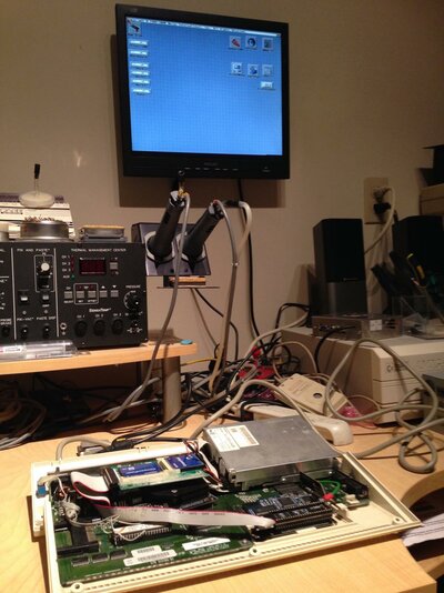

Cleaned and re-greased the floppy drive, re-installed it, the A604 and Indivision ECS, and then tried to boot:

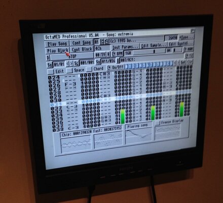

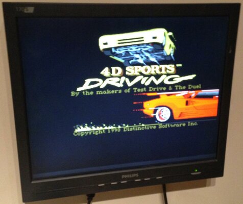

Happily greeted with the last installation I was working on; SysInfo looks good but time for some real tests.. :)
Audio sounds great with OctaMed, both channels clear and well-balanced. 4D Sports Driving working great and all appears stable.

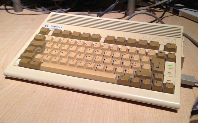

And finally, everything back together and ready to entertain again :thumbsup:
