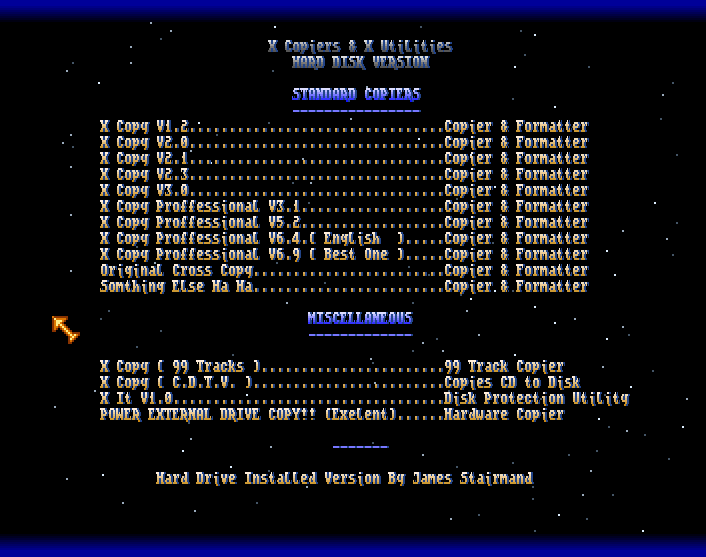

Alternatively you can use the most famous Amiga disk duplicator software: X-Copy
You can download a bootable adf of it from here:
It has a nice gui to guide you copying disks but if still looks complicated to you, just search on YT and you will find many videos about it
