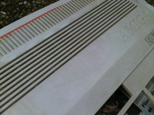

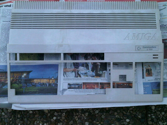

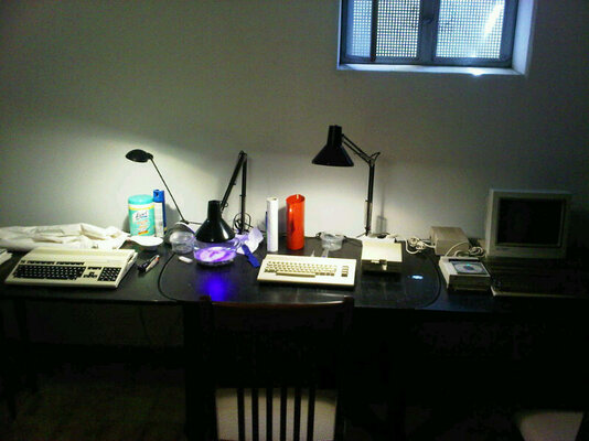

Well... this is the result of my first attempt. Can this be salvaged, or should I count my losses?
I applied the Retr0bright about 4 times - the first three times with a fairly thin layer @ 8 hours each under UV-Light. The last application I used a thick layer, hoping to even out the spots @ 12 hours. However, no success...

Hmmm.... that doesn't look like 'bloom' to me, that looks more like flow marks made by the plastic polymer as it flowed through the mould, or possibly a badly mixed masterbatch of plastic.

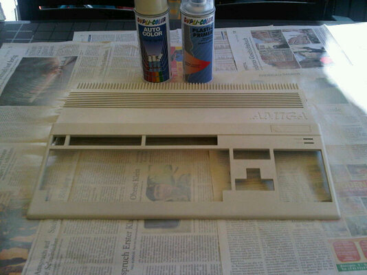

I could be the bearer of bad news here :(. Those marks aren't likely to be removable if they are what I think they are. My best suggestion is to pop down to the local auto parts shop and see if they have any Ford Sahara Beige acrylic paint, as that is probably the best match for the A500 plastics and acrylic paint will be the most compatible with ABS plastic.
Hi Merlin,
thank you for your feedback, I appreciate it. :thumbsup:
I will try to save the case as per your suggestion and get the acrylic paint.

Did you bought which kind of peroxide?
Did only used a teaspoon of oxy pre-diluted in hot water?
Those stains are common only in way too concentrated formulas, both on the peroxide side or the Vanish/Oxy/TAED.
When using the formula, please remember that slow is always better, so a low concentrated gel is better than a way too strong one.

I am using Merlin's original recipe from the wiki...
I used 15% hydrogen peroxide from the pharmacy.
I did not dilute the oxy in hot water - is that recommended? How much water should be used to dilute?
And yes, I may have used too much oxy... half a teaspoon (not 1/4) each. Would that already be considered "way too concentrated"?
That's not too much Oxy, but you need to pre-dilute it in a bit of hot water.
Chances are the Oxy didn't diluted well in the cold peroxide and landed over the plastic, causing that bloom effect. But I doubt it.

I think the problem was indeed that the oxy did not dissolve properly in the gel and therefore had different concentrations. Also, applying the gel 4 times was probably not a good idea. Now that I found a good and cheap supply for H2O2, I don't have to be too cheap with the gel ;)

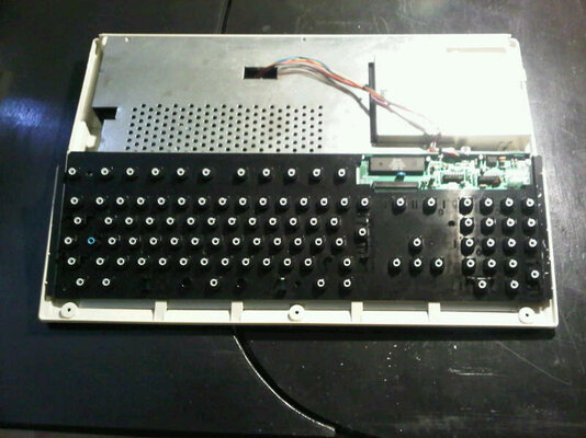

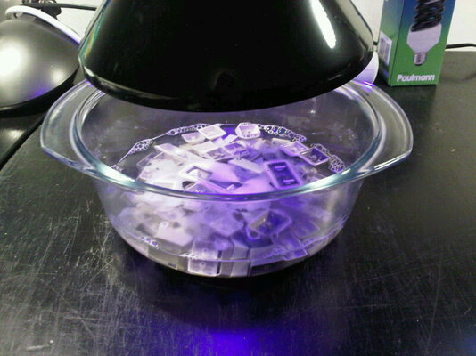

Well, I found the EXACT original beige colour by chance and the result was amazing. (see pics). Now I am only waiting for the keys to be done and then the final result should be acceptable. (of course I will post a pic, because we love them).
Next project: C64.

Was the colour of the paint you used actually Ford Sahara Beige? If not, what is the exact shade of paint you bought (car model and name of colour)?
You can see the acryllic spray paint in my picture - "Dupli Color - Auto Color". The name of the color doesn't show anywhere... it was simply shown by the color of the cap. After spraying 2 layers you cannot see the difference between the inside/backside of the top cover (which never had any yellowing) and the top side. It looks like new. Of course I started with a primer for plastics (also seen on my pic), then 2 thin layers of paint, followed by 2 thin layers of transparent acryllic varnish. Had I not scrubbed the surface too hard, it would also feel like just out of the box. Now its a bit rough, but I actually like it. Once the keys are finished (takes forever!) I will put up a pic of the final and complete unit.

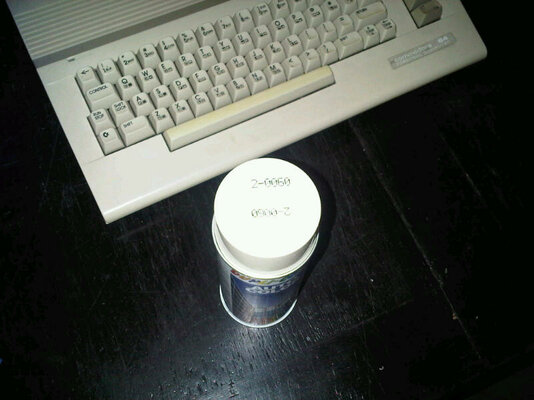

Thanks Khondar. There may be an inkjet code on the domed bottom of the can; if there is, please post it and I'll find out which one it it.
:thumbsup:
Hi Merlin. Here are the pics with the article code of the spray paint. Code is on top of the cap.
