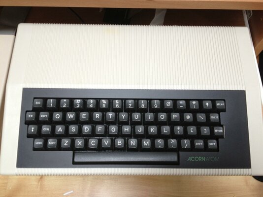

My Atom, just a quick refresh

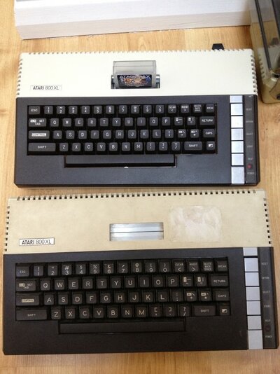

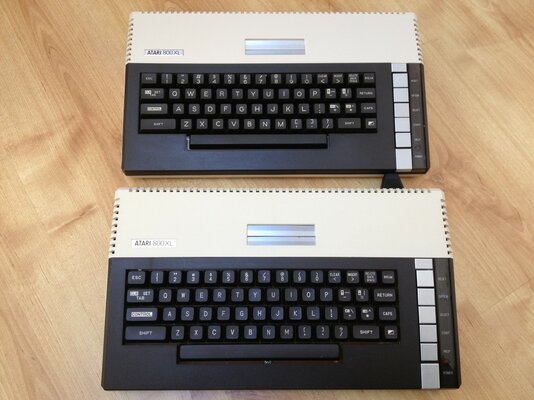

An 800 XL for TheCorfiot (his at the top) -in part exchange for all his cool electronics fixer-up-ery
The before pic shows his at the bottom before a clean up and retrobrite

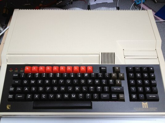

my master. need to do the base again sometime.

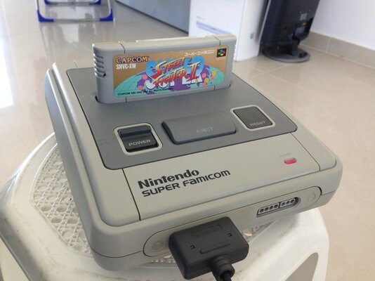

and a quick in-progress of an extremely oddly suntanned STe. 45 mins in the sun perched on brick on the wheelie bin facing the sun!, another rotate and blast over the weekend and it should be ready.
How did the STe turn out? I'm just trying the same with my ST case but could take a bit longer as the sun isn't as strong...
i think its important to keep it really topped up, and do lots of passes, do it gently
its ok so far but the retrobriting isnt nearly as even as normal. naff plastics :(

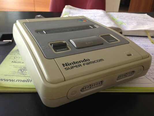

This is the same Super Famicom after some treatment and about 3 hours
