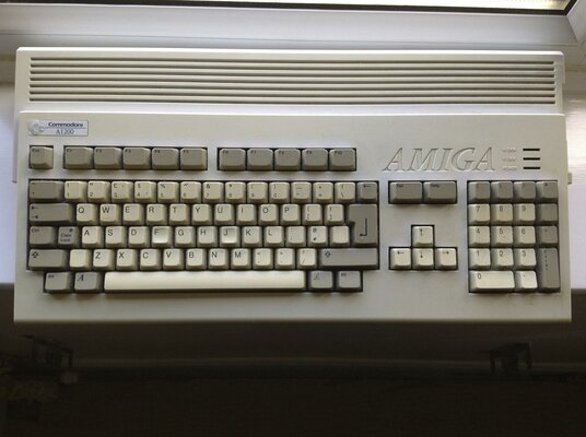

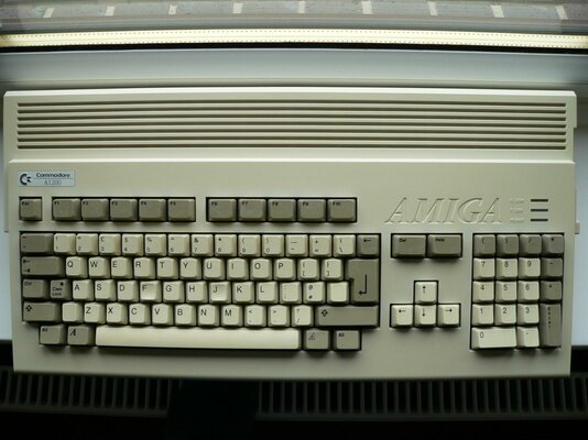

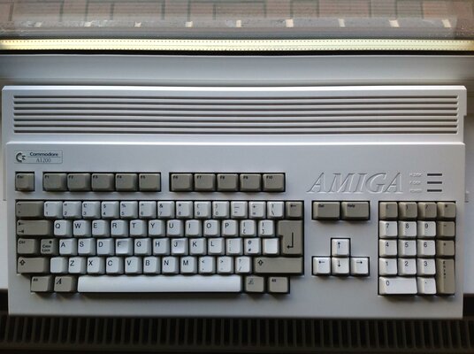

Last year I decided to retrobrite my Amiga 1200 as it had become discoloured.
I was pleased with the results on the case, although some of the darker keys had started to bloom, but I could always get a replacement keyboard. This photograph was taken on the 17/09/12, after I had reassembled the Amiga.
Other than a week, where the Amiga was out, but not in direct sunlight, it has been stored in its original box in the back of a wardrobe, away from any light or heat source. So I was disappointed to see how badly discoloured it had become in just over a year.
I am considering retrobriting it again, last time I didn't use any lacquer or varnish. Specifically, I'd like to know what type of lacquer or varnish people used and what were the long-term results of it?
