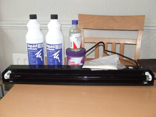

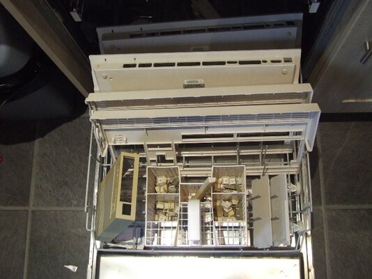

Ok - finally got my liquid peroxide 12% - stuff in the dishwasher, ingredients laid out, goggles and gloves to hand. I promised Merlin a long time ago I would take photos, which I am. Do I post them here or in my photo album or somewhere else?
Please, post them here... we are waiting for them.... please also try to keep them fairly small (say 800x600) so that pages don't take too long to load; remember, we have Amiga users who use them to access Amibay.
Thanks
Ok then - Exciting dishwasher pic - I think I shall just start with the keys and with external floppy cover
2nd pic - my indredients and UV bulb

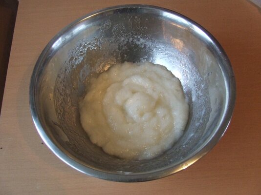

Was much foamier and gloopier than i imagined it would be. First pic is 500ml of 12% and xantham gum. 2nd is after the glycerine. The mixture held onto the spoon as shown in the pic.
I only had a hand blender, but gloved and goggled I felt confident it would be ok. In the end there was no splashing.

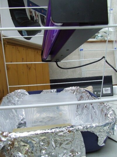

I have foiled an old cat litter tray about the same width as my UV tube. The conservatory seems a good place for it away from pets etc - plus maybe the extra light might help it in there.

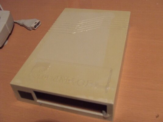

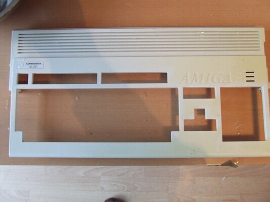

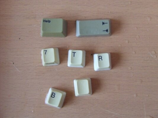

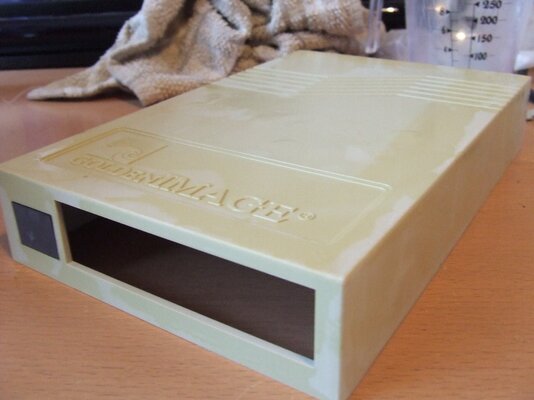

So dishwasher finished - mine decided to send keys all over the place - so after scooping them up we get to piccy time: Before Shots

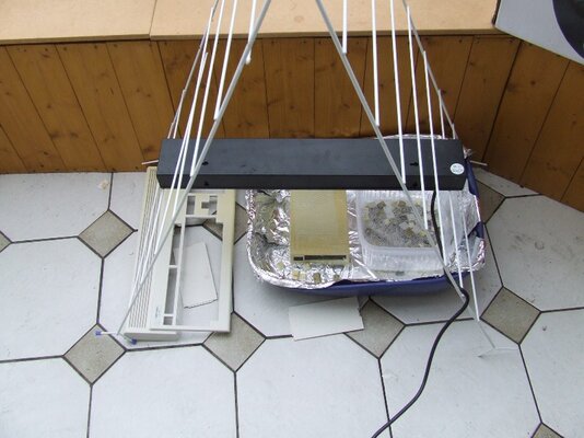

Added the oxy, gave it a wizz and started painting. Soon realised that painting each individual key was going to be a nightmare, the mix is gooey and very slippery, so made up a tub with peroxide and oxy in for the rest. Just left those I photoed out and painted them the the gel mixture.
Set up the lamp and an old litter trail lined with foil and put them in the conservatory. Time was 2.40pm when I took the pics.
Wait and see time

He should see something happening in a couple of hours. Check them after 4 hours and see if you can detect a difference.

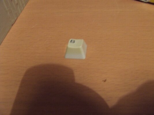

Okay, after 4 hours........ and the conservatory glowing like a space ship - or a pot factory!

The light is artificial now, so its difficult to judge properly. But to me, Im not seeing much.
Before >>>>>>>>>>>>>>>>> After

Patience....... the results don't come straight away.
Those of us that have done this know that the reaction goes on for a little while even after taking parts out, so what you see now may improve by tomorrow.
Natural UV light whups artificial UV light any day of the week, but not at night , obviously....:lol:
