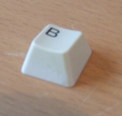

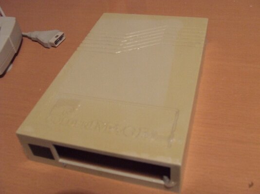

Okay, this morning - didnt have time to examine them properly as I was on my way out for the day, but upon returning, we are having some positive results. The B key is whitening, you can still see the line between the lower white colour and the upper yellow colour, but it is getting there. The 1200 case has brightened very well so far. The external floppy drive is still quite yellow, but to be fair it was the worst affected of all of them. So all three B key comparison pics.
So looking good so far.

@ craigbelshaw
Good stuff!! Slow is the way to do it; that way you don't risk attacking the ABS polymer.

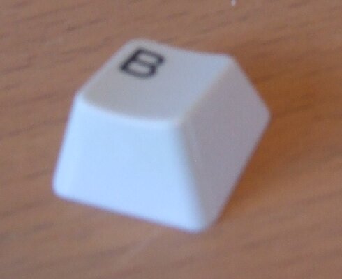

Again this morning, very little change from last night, but sunlight seems to make all the difference - it whitens much more quickley during the day. Only by examining the key closely can you see the two tone colours. The disk drive is still some way off being done.

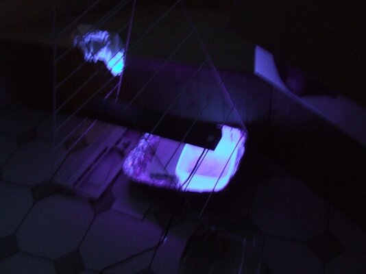

I found exactly the same: sunlight is the key. I have a UV lamp, but that seemed to do little...
....but it looks way cool at night
Yup, they certainly load up the Oxy with UV brighteners, don't they?
I went to college with a guy that worked for Ciba-Geigy when they were at Clayton; they made these UV brighteners (or up-converters, to give them the proper name).
His lab coat glowed so much in sunlight, we reckoned he was getting skin cancer from it!!

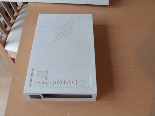

The case is nearly done. The picture was taken during the day, which makes it seem brighter than it really is, the original shot was taken in the evening - so it does look good, but in reality isn't as bright as it seems on the picture.
The main reason it took me so long to get started was due to the fact I could just get cream peroxide - I thought that this would attack the plastic. But, the concurrent retr0bright thread on EAB recently mentioned this was fine. So I have another batch of bits using that and a small sprinkle of oxy. This time they are in the garden, I'm not sure how much the UV bulb actually did. As I said earlier, all the brightening seemed to take place during the day.

Aye, we have definate results. The cream peroxide mixture seems slower, which is a shame as its a lot easier to put together and much more pleasant to work with. Stil, patience is a virtue ..............
