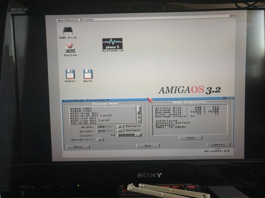

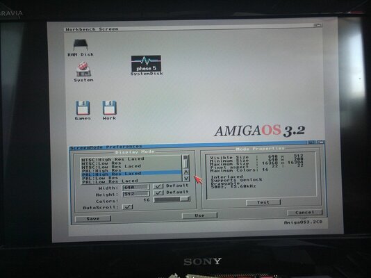

Right showered, woke up and got a coffee ☕ and in the messy mancave.
CDTV loaded and here are some pictures showing the system and screenshots
As you can see no other options I've had a similar issue when installing RTG cards, if I remember correctly that required an addition line in the Startup-Sequence wonder if it's the same added a pic to show it just has LoadMonDrvs in SS
Ahhh, you are using ClassicWB.... that might explain it. I stopped using ClassicWB a few years back as I had no end of issues with things working. Is that version of ClassicWB using Scalos?
I'm not using the Scalos version of ClassicWB
what ill do is just try a clean install of OS3.2.2 using what @DjCook mentioned on his CDTV TF536 thread to also improve IDE speed
Same again using a basic install of AmigaOS 3.2.2 no ClassicWB elements added.

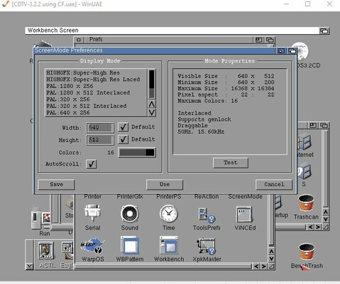

I've been able to get the A2024 ones to come up on it with the classicWB build but because you weren't interested in them I deleted them of my CWB 3.2.2 build and this mode doesn't work with my RGB2HDMI
If I load this basic AmigaOS3.2.2 Setup on winUAE all modes load up
I'm gonna try my ClassicWB setup with winUAE to see what happens there too

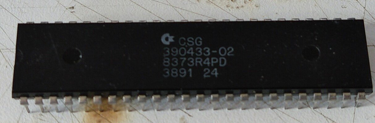

I did take a picture of my Denise IC anyone able to tell me what model it is maybe its the original OCS? Not sure myself I'm usually using my AGA machines

Update: Not my CWB 3.2.2 build WinUAE shows them, so I feel it might be my Denise restrictions
if I set WinUAE to OCS, ECS Agnus & ECS Denise it does not show them only if it is set to Full ECS
so I need to see if I have a newer Denise I believe there maybe more to it though
little update had a look online and I have confirmed the Denise in this CDTV is an OCS version so I will see if I have a Super Denise anywhere.

8362 is an ocs Denise I believe matey, you want the 8373 for a Super Denise.
They are straight swappable
You should have asked, i've probably got a spare i could have sent you lol
Maybe.... I have one spare, I'll pop it in the post for you tomorrow
