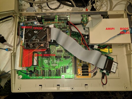

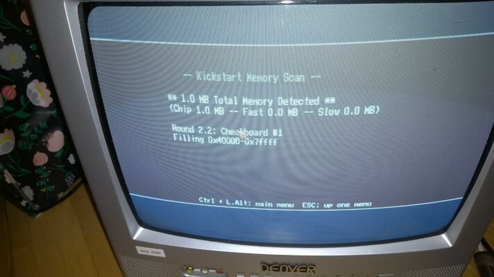

I have to apologize to Djcook for not answering in time but due to real life problems I just had the pleasure due to the Sukkopera's new relocator and a local friend that had the patience to bare me all this time I manage to have an Amiga that can do a lot of thinks at the same tine.
With the accelerator TF530 can load wb 3.1 and play WhdLoad games and with the AMIPI from MasterGR from here http://www.retro4fun.gr/pbb/viewtopic.php?f=16&t=464 I can have all games programs load from an SD cart and even emulate 4 drives at the same time.
Unfortunately My GVP a500 HD cannot work together under any circumstance.
A big thanks to Djcook for the accellrators that he is preparing.
Just a photo amiga500enchachedA.jpg to show the glory of Amiga.
It is included a boot selector and due to the relocator from Sukkopera a rom switch and an indivision v2.
So Amiga can but either from real Floppy and 1.3 or 3.1 rom and with the AMIPI from any ADF again in 1.3 or 3.1 rom.
The perfect combination (for me) a pure Amiga 1.3 with real floppy or SD with all the possible ADF fitting inside and an upgraded 3.1 with two floppies and a CF as hard disk.

Just a photoView attachment 143878 to show the glory of Amiga.

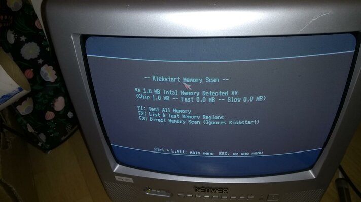

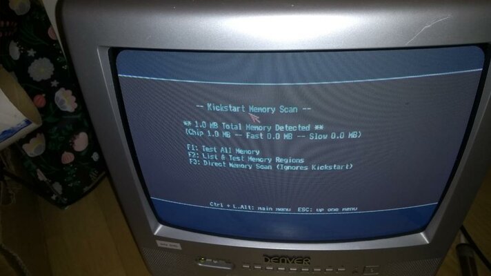

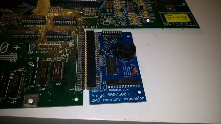

I don't understand the issue here.
I have a BooBip on my A500+. I modded the A500+ so it can have 2MB chip RAM (from BooBip board) and 1 MB slow RAM (the internal RAM turned into slow RAM) with a RTC running on BooBip.
So it should work with a TF530 if the only limitation is not exceeding 1MB of *slow* RAM.
The problem behind it is that TF has issue with 1.5mb slow ram, and boobips expansion doesn't allow to limit it to 1MB while PeteAu's expansion let's do it
So there are following options:
1. Use PeteAU's expansion (limited to 1MB slow ram)
2. Do a firmware rollback and use full 1.5MB slow
3. Upgrade your A500+ to 2MB chipRAM (with PeteAU expansion )

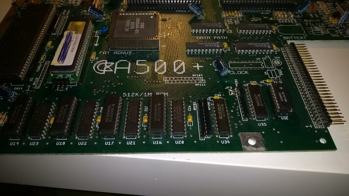

I think that my best option so far, and the cheapest, will be to convert/upgrade my mainboard to full Plus spec's. Well.... Nearly full spec's, as I am not going to install the clock circuit. I have no need or use for such a feature in my machine. If I need to do it, then it will be because of wrong date stamps on files. Yet if I can run the machine without clock, then there is no need for that.
Well...

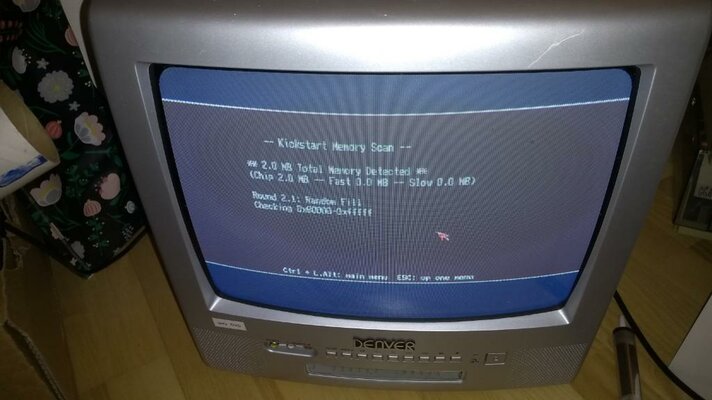

I have done the 500 revision 8a.1 to 500-Plus convertion now. Sporting 1mb onboard mem, and any trapdoor (up to 1mb) will be alocated as Chipmem now. Yes. I have 2mb Chipmem right now.
So the question is now. Will I still be able to use the Gary adaptor for adding FastRam? As all Chip are alocated, or will even FastRam conflict, because of the fact that there is memory added with the use of the Gary adaptor. Hmmmm.... I will wait untill I get my MeanWell RT65b power supply that I need for replacing the internals in a dead heavy-a500-PSU.

Sweet..... This might finally be the solution to my complaints, that brought this issue to life. Price is not bad eighter. ;-) How high does it reach? I am thinking about, if it goes closer to the Denise chip or if it is the same space between the new relocator and the Denise chip, as the old relocator. The old relocator makes 1mm room/space between the relocator PCB and the PCB on the ScanPlusECS scandoubler. This is critical to my needs, as the relocator's PCB is at the same hight as the scandoubler's PCB, measured from the surface of the mainboard.

I have the new relocator in my 500 now as well. And I want to show off what my TF-530 setup looks like, so I am linking to my blog here below. I am really pleased with my setup, and as I was adviced, I have done the ChipMem mod, and are running with 2mb Chip + 2mb Fast from the TF-530. I so love this accelerator. Thanks for letting me buy one, and with the standoff's it is possible to add a scandoubler as well.

However Systest shows 1MB Chip and 1,5MB Slow??

Wow! Excellent!
That is because you did not read the entire blog post.... :D I changed the Ram configuration by doing a ChipMem upgrade and is running the trapdoor as ChipMem now. Hence 1mb Chip on the motherboard plus 1mb Chip from the trapdoor and 2mb Fast from the TF-530.
