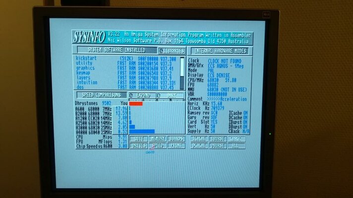

Finally had a chance of getting the TF-530 running, that I bought from you some time ago. Sorry for the delay. The card it self, is working beautifully without any issues. The CF/HDD solution is working beautifully. And everything is just great. I just have one slight problem, when trying to fit it, alongside a dual-kickrom with key licensed by cloanto. You know. Those kickrom switchers that are two-in-one chip. Because it is too high, the relocator will go over the top left corner of the kickrom chip. Only solution to have it running, is eighter to use a single chip original kickrom. Or have some sort of kickrom relocator. Or to use a kickrom switcher that are extended with a ribbon cable. Regarding my ScanPlusECS scandoubler (the one from Irixlabs), then the reloocator and the TF-530, will indeed fit, with the scandoubler installed. The bottom part of the scandoublers pcb and the top of the relocator pcb does not touch each other. There are an aprox 1 to 1.5 millimeter gap between them. And the TF-530 board it self, does not touch the Denise chip at all. This however recuire you to install one row of socket spacers/extenders between the cpu socket on the mainboard and the CPU relocator it self.
I am happy with the purchase. And have done a little screenshot of sysinfo, with the accelerator installed. And I used an ATX PSU with an homemade adaptor cable. (ATX-to-SquareDIN)
